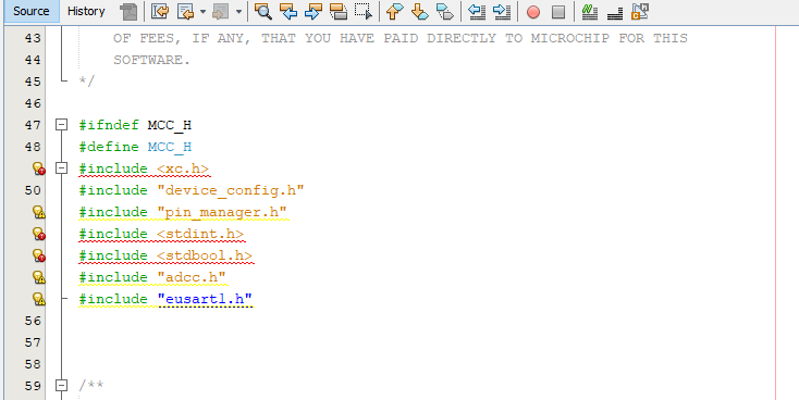

Why is Mplab 5.20 a mess
be80be
Im trying to use the ADC and printF
and getting these errors

I know you all right I just don't get the fact that there own bull xxxx don't work i was doing the sample from there site
and there own code
printf("\n\rThe ADC Value is: %i ",ADCC_GetSingleConversion(channel_ANA4));
Gives a error
Then all them dumb errors come to life after that.

I downloaded your zip file.
For whatever reason, the printf line came through with '?' instead of " when I made them quotes: printf("\n\rThe ADC Value is: %i ",ADCC_GetSingleConversion(channel_ANA4));
It built just fine - no errors at all. Of course I get a ton of warnings:

Edit: Finished installing 5.20, no difference although it gave me a configuration defaut error when MPLABXIDE loaded, which was resolved simply by specifying or re-specifying the compiler (c in the tool chain xc8 2.05).
be80be Are you getting errors or warnings? Also, I don't see where you are defining POT

The Adc.c file is showing ton's of errors
guess i need go back on my mplab this 5.20 looks to be missing something.

Ok the problem is the printf
This just doesn't work
printf(?\n\rThe ADC Value is: %i   ?,ADCC_GetSingleConversion(POT));
I be dam lol
The problem was these ? should of been this "
printf("\n\r The ADC Value is: %i   ",ADCC_GetSingleConversion(POT));
