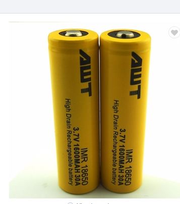

i have attached a image of battery is it the correct one?
Yes, those batteries should be fine.

If the mains is that bad, I would suggest using two (or more) 18650's in parallel!.
