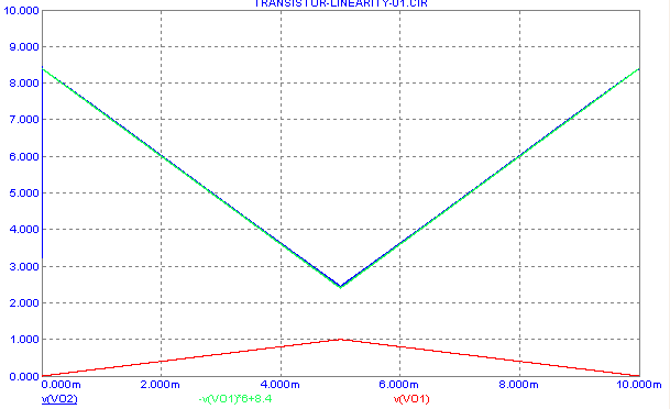

Hello there,
If you have an amp that has good linearity and swing and scale all the resistances up, you get a little less gain but still good linearity and swing, but a little more swing if the transistor was operating in the higher saturation area. That's because the saturation voltage is less for less collector current.
The reason the amplifier has good linearity is because the forced gain is less than the circuit gain, and the emitter resistor provides for negative feedback. A smaller emitter resistor would result in larger swing, but not as good linearity.
Here's a shot of a transistor amplifier showing how good the linearity is. The upper trace is actually two traces:
1. The actual transistor output, and
2. A computer generated trace of a perfectly linear transistor amplifier with zero non linearity.
You cant tell the difference so well that's how good it is. Transistor is 2N4401.

Hi Mike,
Did you try setting the 'gain' to 10 instead of 20? Also, comparison using different values of collector resistor (and thus emitter resistor also and possibly bias) would be nice to see too.
The best view for the linearity is to see a 'perfect' triangle of the same amplitude very near to the actual output. That immediately shows any curve (non linearity) very clearly. I would imagine a careful hand could even draw a straight line right next to one or both sides of the output triangle, but an internal generated wave is probably better such as the scaled and offset input waveform itself.
So evident and I never considered that! Always used sinusoidal input...!
