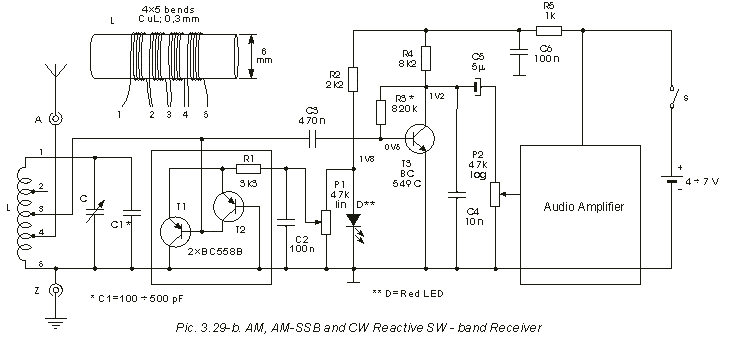

Could practically this type of circuit be made? Is there a simpler/better solution?
(I'm am new to electronics)
The idea was to use the oscillations produced from the LC circuit, then amplifying them with an OpAmp or more and the use a transformer to further increase the peak values. Could this be made or I am missing something, even getting all wrong. I tried with LTspice but the results where not encouraging.

Is the symbol at the start of the circuit supposed to be an antenna?
It looks a bit like it's supposed to be a TRF receiver, though that could be coincidence..
Yes the symbol on the left is an Antenna. So based on the L anc C it will produce oscillations. My purpose is amplify these sinusoidal oscillations keeping the same frequencies. So my idea was to use an opamp or more to amplify the signal and then use a transformer to further increase the voltage. Is this possible? I'm missing something?
The circuit you show uses a parallel tuned circuit, in series with the antenna; that would reject the frequency it was tuned to rather than select it.
A parallel tuned circuit should connect between antenna and ground, as in the example I posted.
In reality, the antenna would usually either connect to a tap on the main coil, or a coupling coil with far less turns, around the main coil - eg. as in the antenna & first tuned circuit in the example below.
Connecting to the tuned circuit coil at a tap neared the grounded end improves tuning selectivity, whereas anything external connecting to the top "damps" the resonance, like touching a guitar string near the middle rather than a fixed end.
A normal opamp would only work as an amplifier at fairly low (audio) frequencies; if you are trying to receive radio signals you would need to amplify the signal with either suitable transistors or appropriate RF ICs.

Yes, my drawing wasn't accurate but I meant to couple the antenna just like you said.
So from my understanding I can't just couple the oscillating lc circuit to an op amp because the frequency range woud be to low in respect to the oscillation of the radio waves. And so i should use and RF IC to make it suitable for the opamp. I understand the issue of the power loss the transformer.

The amplitude across the tuned circuit may well be 100x or more greater than at the antenna, but the matching tap to feed the next stage amplification also needs to be well away from the top of the coil, for optimum tuning.
Simple single tuned circuits like that are not very selective and will likely pick up other signals which are near in frequency. That's why practical radio receivers are generally far more complex, with multiple tuned circuits or band filters of some type.
The Superheterodyne system has been the commonest approach for decades. With that, the wanted signal, after the initial front-end tuned circuit frequency selection, is "mixed" with an oscillator (local oscillator) working at a fixed offset from the tuner frequency.
The mixer outputs are the sum and the difference of the two inputs. The difference is a constant, as the local osc tunes at a fixed offset from the front end.
That constant frequency product means all the rest of the RF amplification and filtering can be done at a fixed frequency, with as many gain and filtering stages as needed, before eventually demodulating it to produce the audio or data etc.
