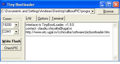

i'm a little confused about the Tiny bootloader that Jay was talking about, is it a .hex file to program into the PIC or is it software like Mplab ?? from the previous post i understood that Tiny bootloader has the same function as Mplab(i used mplab to upload program into the PIC thru picstart plus,now i want to upload programs from home using serial port) so could i just use mplab instead of the the tiny bootloader ? is it the same ?? and i still need to upload a bootload .hex file into the pic thru picstart plus b4 i can do so right??
i went thru the tiny bootloader site and i cant find any bootloader .hex file. could anyine help me out here??how do u rite a bootloader hex file?

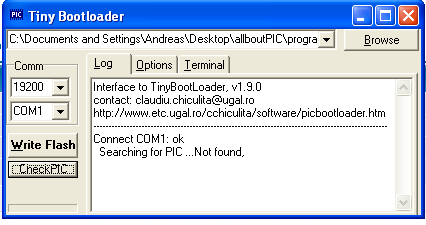

Jay .... i tried to use the Tiny bootloader ... but it can't seem to work it shows this
Did you program that PIC with bootloader HEX before with normal programmer? It won't work without it.
yes... i did .. i changed this
LIST      P=18F4320	; change also: Configure->SelectDevice from Mplab
xtal EQU 20000000		; you may want to change: _XT_OSC_1H  _HS_OSC_1H  _HSPLL_OSC_1H
baud EQU 115200			; standard TinyBld baud rates: 115200 or 19200
to
LIST      P=18F452	; change also: Configure->SelectDevice from Mplab
baud EQU 19200			; standard TinyBld baud rates: 115200 or 19200
it's correct rite??
but i think there might be a problem with the mplab in the lab.. i think i'll convert it to hex at home then try again ...
