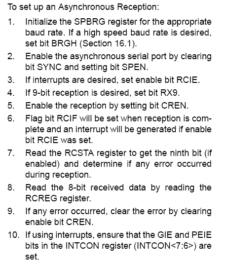

so i need a code so that the USART will work rite??
would it be this??
movlw D’25’
movwf SPBRG ;initialize SPBRG
movlw H’24’
movwf TXSTA ;initialize TXSTA
movlw H’90’
movwf RCSTA ;initialize RCSTA
i got it from somewhere and i dontknwo wat it does
Datasheet again:
so .. do i have to upload this program to the PIC thru a programmer(pic start plus) b4 i can use the serial port??
Yes exactly, BUT you don't have to write your own bootloader, there are a plenty of pre-made ones! Just go to Tiny Bootloader site and download it there (I contributed with code for 18F4320 ).
