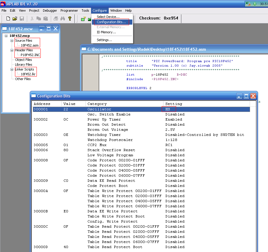

so does it mean when i upload this prog ... i have to set it in the mplab i use?? if so .. how do i do it?? .... or do i just upload the program u sent me straight into the PIC thru MPLAB?? and are all the protection flags off so that i can reuse the PIC??
The HEX file has config bits set correctly, if you want to use and compile ASM file, you have to set them in MPLAB.
Here is a screenshot, red framed things are esential.
For pic16F devices, setting the configuration bits in MPLAB only tells the debugger (MPLAB SIM for example) how to run. You still have to add the configuration bits to your code if you want them to be incorporated into the HEX file...
Is it diffirent for Pic18F devices Jay ? Could be, i didnt try yet...
Oh I just verified that MPLAB doesn't save Config Bits into HEX file (strange, it works with ICD2), Neither with 18F.
Start a new project, and then right click on that panel and select Add Files, INC and LKR files are in "C:\Program Files\Microchip\MPASM Suite"

OK I found a workaround, go to File/Export and save HEX. This way it WILL have Cinfig bits inside HEX.
