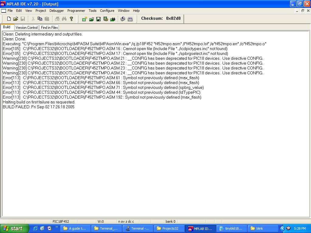

well... i programmed it the way i programmed the others... the others worked fine .. but after i programmed the bootloader into the PIC... it didnt work... Tiny cant detect it ...
Jay .... i got this while compiling the bootloader..
OMG, you mustn't move the source file which has additional include files (those icdpictypes.inc and spbrgselect.inc) out without them! Just compile dirrectly in Tiny folder and it WILL work.
thanx Jay ...
