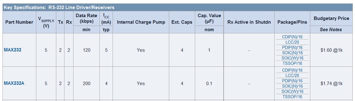

Whats the difference between MAX232A and MAX232 ?
aljamri
My college in Mechanical Department, wants to do an electronics project, part of that he is using MAX232A IC. When he searched for it he found just MAX232 and he is asking me the difference.
I’ve searched and found the attached from MAX page, it shows the only difference is the data rate and the nominal cap value.
The question, where to use each of them ?
Thank you
