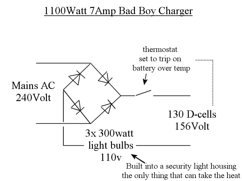

i already built one battery charger but now i'm trying to make it more efficient. here is my circuit. its only 65% efficient and it wasts a lot in the bulb. i use it every day and its really fast charger.
i was hoping i could replace the bulb with a triac and that would still limit the current but not waste energy as heat. sorry my electronics is really basic. i may buy that art of electronics book.

A triac dimmer requires a resistive or possibly inductive load to work properly. The battery is a very low impedance load which would create very high current spikes in the triac so you still need some resistance in series with the battery. If you reduce the voltage with the triac then adding more bulbs in parallel would reduce the loss for the same 7A current. Since light bulbs change resistance significantly with load, you'd have to experiment with the number of extra bulbs need for optimum operation. (You do have a meter to measure battery current, I assume?)
CAUTION: Your schematic shows no isolation from the mains. I trust you know that's very dangerous since there are lethal voltages everywhere in your circuit. Touching any part of the operating circuit while grounded will likely kill you.

They are just in parallel with the bulbs you are already using. The triac would work off the lines and drive your bridge rectifier.

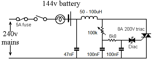

would this work? what are sugestions for component ratings for 240v mains 144v battery ?

hi Nigel,
My concern is the total lack of isolation from the mains supply when using this circuit and what happens if the triac fails s/c.
IMHO this circuit is potentially lethal, I have cautioned the OP, perhaps he may listen to you.:)

ops, i missed out the bridge rectifier! assuming this is present will it work? it is going to be a light weight emergency charger so that i can carry it on the bike all the time for if i run out of charge unexpectedly. it needs to be light weight so no transformers.
but honestly would a transformer make it any safer anyway? -its 144v at 5 amps! i use one of those fast trip plugs for lawn mowing just incase, but i don't know if that is adequate either. :(
The transformer makes it safer since it isolates the circuit from ground.
But one of the fast trip plugs (which I assume is a ground fault interrupter or GFI as it's called in the U.S.) should definitely be used if you insist on connecting the charger directly to the mains. They're designed to open the circuit before a lethal current (which can be as little as 15mA) can flow through your body to ground.
NOTE: A GGI provides no protection if you touch the two mains at the same time, they only protect against mains to ground current (by checking for an inbalance between the two mains currents).
