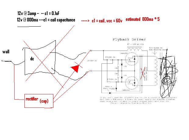

so i seem to have OL the smaller driver somehow, so I'm going to be rebuilding it, however iv been thinking, by decreasing the capacitance current goes down, so maybe i could step volts up,
working with the old one i believe i used around 1uf eqivilant capacitance at 13v used 1.5 amps, (that was (20 parallel rows of (2 x 0.1uf caps in series)) so 20 watts, which was just enough to boil a small sauce dish of water, which is ideal.
by removing the caps it ran at about 100ma @13v,
so if i do that and then multiply the input voltage by 5, which brings me up to a rectified mains 60v, that would bring up my current to 500ma? and power to 30watts?
my problem is that a power supply for the original is costly and limited to 12v, plus all the extra space for the capacitor bank, with the new concept im eliminating complex supply(replacing with fuse, rectifier & cap) and extra work coil caps, but can add those caps as i go if i need more power,
with that im still close to ideal output, but do i need to think about wiring bases differently? and will this plan work?
Now thats a little confusing, the parallel capacitance will make the system resonate at a given frequency, your circuit being driven rather than self resonant means that at the right capacitance the current will be minimum (tank resonating at the driven freq), what you ought to do is find the capacitance the provides the lowest current, you can do this trial and error, or you can build a simple circuit that will make the tank resonate at low power and tweak it.

photo is what i want to do.. but i wonder if i need bigger resistors or diode clamps with that much more volts going to bases....

I see.
It just so happens that I have that same circuit connected up to a telly flyback trans here in my 'shop, and my bench supply goes to 60v.
I tried it, as soon as the supply got to 24v, the voltage of the zeners in my circuit current went straight to the limit point, I think both fets turned on. Initially it looks like the zeners need to be higher in voltage than the supply, that might be possible to do but you'd need to make sure the fets can withstand the zeners voltage rating on their gates, most can only take 20v or so accross gate source, at 60v supply 1k might be a better choice for the r's.
