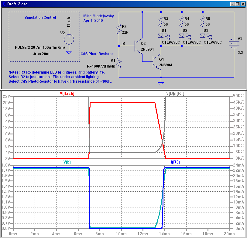

LTspice and KiCad are free but not easy to learn.

I second Mike ML on using LTSpice. It's probably the best free program for doing analog circuit simulation. And it's great for a beginner learning about the basic circuit elements (inductors, caps, transistors, etc.) and their characteristics. It's a lot easier to simulate a circuit than build one. I never build a circuit without simulating it first.
