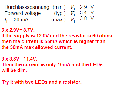

No they aren't. They might be 3.4V.
They are anywhere from 2.9V to 3.8V.
Your 60 ohm resistor will overload the 2.9V LEDs and cause the 3.8v LEDs to be dim.
Try it again with only two LEDs in series with another resistor.

Mouser doesn't make the LED. I looked in Google for it and the first link is Digikey where they have Osram's datasheet that I copied.
https://media.digikey.com/pdf/Data%20Sheets/Osram%20PDFs/LB_LT_E6SG_Pb_free[1].pdf
When you buy an LED you don't know if the manufacturer had low voltage ones or high voltage ones for the last production run.
So the datasheet shows the range of the low and high voltage limits.

Your 3rd question was about what (do) those datasheet figures actually mean. I explained.
No, you didn't. But since you asked, I'll try again. In the datasheet, there are two values for forward voltage (you posted a snippet of it in a picture up there):
Durchlassspannung (min) | Vf: 2.9V
Forward voltage (typ) | Vf: 3.4V
So we know that "Durchlassspannung" just means "forward voltage". My question (which you didn't answer) is, what is the difference between these two values given in the datasheet (2.9V vs 3.4V)?
I proposed that the first figure is the minimum forward voltage for the LED to emit any light, and "typ" is the typical operating voltage. I don't know this is the case, but it certainly seems plausible.
So what is your explanation of the difference between these two figures? Remember, this is for one particular LED, a green one.
No.
The forward voltage is a range of voltages. One LED can have its voltage that is within the range. The voltage range for this LED is from 2.9V to 3.8V when its current is 30mA.
3.4V is the "typical" voltage which is close to the middle of the voltage range. This LED is sold in 3 sub-groups of forward voltage range.
Since the current is 30mA when the forward voltage is measured then the LED is shining very brightly, not barely emitting any light.
