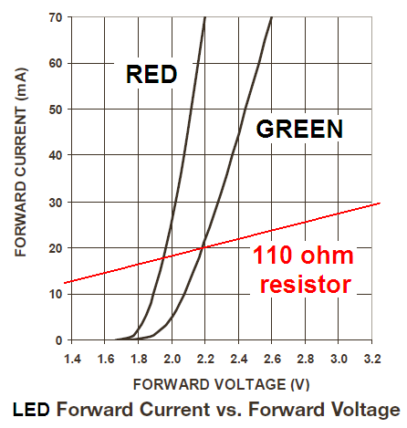

But an LED is not a resistor, it is a solid state diode.
If you feed 2.2V to a 110 ohm resistor the current will be 20mA.
Then if you feed 2.6V to the 110 ohm resistor the current will increase to only 23.6mA.
If the LED voltage is 2.2V at 20mA then if you feed it 2.6V its current might be 70mA and cause it to burn out.

Then is there a way to "calculate" the Current usage of a Typical LED Based on Voltage and erm...
[I can see the pointlessness of this question as nobody would care for the current an LED can draw once it's dead, ha ha ha but I am just curious as it does seems to go against ohm's law here, maybe because LED is not an Ohm which is what you are stressing here too :)]
You feed an LED with a current, not with a voltage. The current-limiting circuit or resistor in series with an LED sets its amount of current.
That's not what I am asking :) Let me try rephrasing :)
Your Chart shows the Current Consumption goes up when the Voltage increase.
Is there a way to calculate the Level of current consumption by the LED based on the Forward Voltage other than looking at your chart ?
Every LED part number has a different forward voltage and a different slope on a graph. Even when LEDs have the same part number and the same manufacturer their forward voltages are probably different. A forward voltage for an LED is a range of voltages.
Also, the forward voltage changes as the temperature changes.
Again and again, feed a current to an LED, not a voltage.
Another way to look at how the "voltage drop" of a LED (or any junction semiconductor for that matter) works.
A resistor has a fixed resistance. A 300 ohm resistor is always 300 ohms (+/- some small tolerance). The "voltage drop" across the resistor depends on the supply voltage and how the resistance is divided up across the circuit, per Ohm's Law. The current flowing through the resistor is determined by I=E/R, where E is the voltage across the resistor and R of course the resistance in ohms.
To take a simple example of a resistor's voltage drop, take 2 300 ohm resistors in series and connect them to a 9V battery. Each resistor will drop half the voltage, or 4.5 volts each, and the circuit will draw 9/600 = .015 amps of current, or if you calculate the current through one resistor, you'd get 4.5/300 = .015. Now connect the resistors to a 12V battery. Now the voltage across each resistor will be 6V and the circuit will draw .020 amps of current (12/600 or 6/300 each resistor).
An LED, instead of having a fixed resistance, has a fixed voltage drop. In any circuit, an LED with a 2.1V rating will drop 2.1V in the circuit, regardless of the supply voltage. So, if you take a 2.1V LED and put it in series with a 300 ohm resistor and connect it to a 9V battery, the LED will drop 2.1V, leaving 6.9V across the resistor. The resulting current would be 6.9/300 = .023 Amp (23 mA). Connect it to a 12V battery, the LED will still drop 2.1V, leaving 9.9V across the resistor, causing the current to increase to 9.9/300=0.033 amps (33 mA, pushing the limits of most LEDs).
So, unlike a resistor which obeys Ohm's Law and only allows E/R amps of current through, an LED will "allow" nearly unlimited amounts of current through it if the supply voltage is near or above the LED's forward voltage. Of course, this invariably results in a smoke-emitting diode which is impractical in most circuits, so that's why you need a current-limiting resistor in series with the LED.
Well, as it turns out, Ohm's Law does not apply in this case! Shocking, no? But Ohm's Law only applies to devices that have linear resistance characteristics. If you look at audioguru's graph, you can see that a LED is a decidedly non-linear device.
Not quite correct. One "feeds" a LED with both the correct voltage and current. You're correct in saying that one must limit the current to the LED's safe value, but one also doesn't want to apply too much (or too little) voltage across the diode.
To try to clear up your remaining confusion, Bracer, about how a LED can have a voltage drop and how to operate it at the correct voltage and current, look at audioguru's graph again. Notice how the LED curves go steeply upward as the voltage increases, meaning that for small increases in voltage, they draw a lot more current, until they reach the point where they go Poof!.
So what you, the designer, have to do is to pick a point on that curve--the LED's V/I curve--where the LED will be nice and comfy and safe. F'rinstance, for the red LED on that graph, let's pick a point somewhere near where it crosses the red line. Then you use the calculations I showed you earlier to set the size of the resistor(s) in the circuit to put the LED at that "operating" point (the voltage and current you picked from the curve on the graph). That way you can be sure that the LED is operating where it should be, with little danger of burning out, and with enough current and voltage to generate a nice amount of light.
Regarding why LEDs have a voltage drop, remember how I told you that you can treat them as a resistor back there? Yes, audioguru is correct that they are not actually resistors, but hey, you knew that anyhow. Nevertheless, they do have resistance. All electrical devices do; fundamental laws of physics and all. Even the wires we use to connect things in a circuit have resistance. Therefore, having resistance, it has a voltage drop, as all resistances do.
Does this help any?
Thank you so much kpatz for explaining this voltage drop “phenomenon” to me, you’ve clarified the matter to me the fact that the voltage drop of the LED is of a constant type.
This is very important to me because as someone that JUST UNDERSTOOD how to calculate the voltage on the other side of a component thanks to Reloadron and carbonzit (You have no idea how much they have help me in my understanding of this area) and two new Kirchoff law introduced to me by carbonzit makes everything makes sense) makes me “thought” that voltage drop is DEPENDENT on the number of loads on a circuit and must be divided among them [not equally ofcourse as it would depend on each load’s internal resistance as Voltage Drop on the end of the component = Overall Circuit Current x component’s own resistance, seriously I am so grateful for them] and here you are with a BUMP! LED’s voltage drop is NOT dependent on the number of loads and it stands alone as the Alpha and the Omega of constant Voltage usage.
Thank you kpatz.
I now learned even more !
SO HAPPY!
Yes I am shocked, you are right, you absolutely know where my plane of understanding is at the moment, now I learn something new from you again, that ohms law only works on resistance that possess a linear resistance characteristic.
That is very new to me, so….Ohm’s law is not God, doesn’t always work….
I LOVE you carbonzit :)
OK, Bracer, I think you're finally ready. I've devised a little test for you to show that you can now figure this out on your own. (You knew there'd be a test, didn't you?)
Don't worry, it'll be fun, since I'm making it part test, part Easter egg hunt.
So here's the test question. Lessee, turn to my teacher's handbook ... ah, here it is:
You're asked to put 3 LEDs in a device. They will be wired in series, and will be powered from a 12-volt supply.
The customer has chosen green LEDs, model LT E6SG-V2AB-36-1-Z. Find the proper size for the current-limiting resistor to use in this circuit.
As always, show your work.
So you need to first find these parts. Don't worry, I'm not playing with you; they're real devices. Find them, and find their specs.
Go to it. You can do this!
