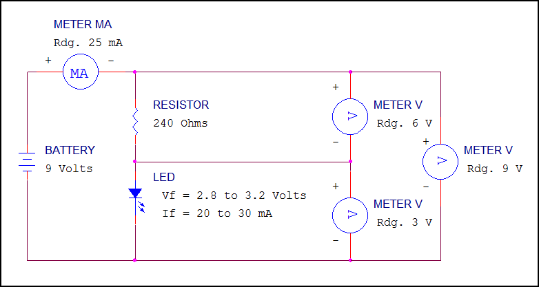

A 9V battery is small so it has a fairly high internal resistance. Its internal resistance is spec'd to be 1.8 ohms when a 9V alkaline battery is brand new. Then if its load is 500mA the battery voltage is only 9V - (1.8 x .5)= 8.1V.
When the battery runs down a little then its internal resistance is 9 ohms. Then with a 500mA load its output is only 9V - (9 x 0.5)= 4.5V and drops quickly.
Let's go easy.
I am stuck because I am given the impression that resistor can drop the current but not the voltage but here I am hearing “voltage” drop after a load.
We need to work on the terms a little. The resistor does not drop the current, it actually serves to limit the current. The result of a current flowing through a resistor is a voltage drop.
Take a look at the attached circuit and tell us what is going on? The battery in this circuit is huge, really huge, even bigger than a bread box. For all purposes my battery can supply infinite current. The volt meters have absolutely no loading effect, their input impedance is infinite. :)
Ron

So....the batteries internal resistance is its own ultimate undoing....

If you don't learn simple Ohm's Law then you will be confused forever.
The LED always has about 3V across it when lighted so the current-limiting resistor has 6V across it when the battery is 9V. The value of the resistor and resistance of the battery determines the current with this LED. But other LEDs might be 1.2V to 3.6V so are different.
Ohm's law says that 6V across your 240 ohms produces a current in the resistor and LED of 6V/240 ohms= 25mA. The current in the LED and its brightness will drop as the battery runs down.
Just focus on learning and understanding Ohms Law right now as it pertains to DC circuits. Pay attention to what AG has posted and think about it. Note in the play circuit I posted how things work and why the meters read what they read. Like anything else, it takes time to learn and understand.
