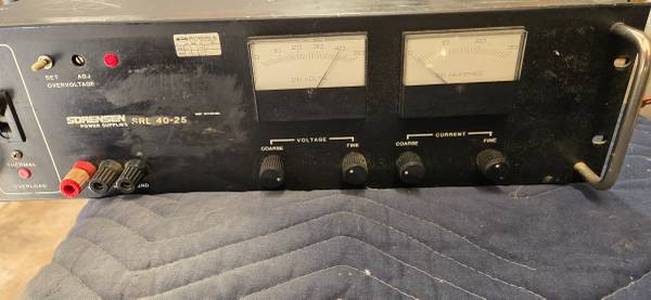

Looking for a voltage regulator, 200VDC to 14VDC at 20 Amperes...
Externet
What is in the market ? DCtoDC buck ? Others ? Any suggestion ?
150 to 200VDC in - 10 A max. input to 14 VDC out 20Amperes capable.
Many normal switched-mode power supplies can work with DC in - the input just goes to a bridge rectifier and gets converted to DC anyway!
14V - is that to be used as a battery charger? If so you could do with a purpose-made one rather than just a basic PSU.
eg. Data on some Meanwell PSUs - if you look at the "input" section of the specs, they are rated for 85 - 264V AC and on the next line 120 - 370V DC.
The XDR-240E-12 one is adjustable between 12 - 15V out and 20A rating.
Check Craigslist or similar. Stuff like this shows up all the time. What's your budget?
