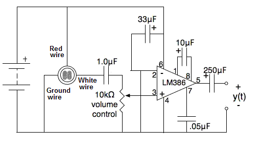

what does this mean
The datasheet for the LM386 shows an RC network (zobel) at the output to ground to stop it from oscillating when the inductance of a speaker causes a high impedance load at high frequencies.
With your 3-wire electret microphone, remove the 2.2k resistor.
Battery, what battery?? Does the circuit need a battery?? Why?? :D :D
The circuit doesn't assume you're running it from a battery. It could be powered from a mains adaptor, a battery or even a solar panel. It's common place to just put power nodes in schematics, in this case connect Vs to the positive terminal and the ground symbol to the negitive terminal.
do u mean connect all the ground symbols to the negative also, the positive and negative terminals on wat the batt or the chip
wait it just hit me that last post u made. so u mean just connect the gound to the negative of wat ever is powering it and connenct the two Vs nodes to the postative of whatever is powering it right?
Exactly!
But I'll show you just to be sure.
Drawing circuits with power supply nodes rather than batteries helps save space and make them easier to read.

Hmmm ... might I ask, what I have to change so that this amplifier circuit works with the output of my soundcard ?
As we discussed, this circuit is missing the RC zobel network at its output.
Its ouput power is less than half a watt.
Its gain is high for a microphone and is less without the capacitor between pin 1 and pin 8 like this:
I got a regular 2 cable condenser electret microphone and I am wondering now how to hook it up. It was originally one cable but I split it, and there was one that had no insulation and one cable that had white insulation. Is the cable with no insulation a ground cable, or is the equivalent to the red cable on the other condenser mic I had, which had three cables? Do I also need to put in the 2/2K ohm resistor, because this condenser mic only has 2 cables?
A 2-wire electret microphone has two pins. One is connected to its metal case and is the ground and the other is its output.
Since it has a FET transistor inside, it needs a 10k resistor to power it (2.2k is too low unless the battery is 3V) and the resistor is its load. Since its output level is very low and its impedance is high, shielded audio cable must be used to connect to it.
