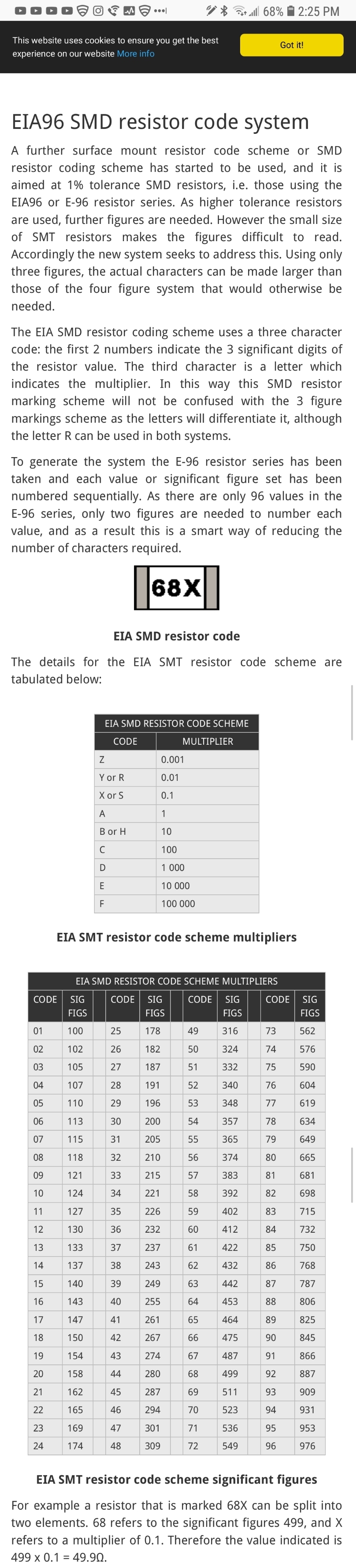

What are these new numbers on resistors?
4.2 OHMs

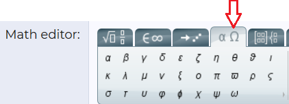

Nigel, how come the "Insert math" button options doesn't have the OHM symbol? It shows in the Tab, but not among the options:
I see "small" Omega, \[ \omega \], but not capital Omega.
Ok. I see it now (pretty small...) \[ \Omega \]
Is there a way to do a better job of placing the symbol?
Middle of the page kinda sucks...

I think blind people who cannot see a decimal point or blind printers that could not print a decimal point wrote the silly 4R2 instead of 4.2 Ohms.
They did capacitors the same: 4n7 instead of 4.7nF. They never wrote frequencies silly like that. 55Hz5 instead of 55.5Hz?

They don't generally need to print frequencies on small components - it's obviously a VERY good idea, as it's much clearer than a decimal point that might, or might not, be clearly visible.
Well, specks of dirt and grim can look like decimel points. Decimel points can also wear off or just not be printed properly to begin with. I've seen more than one component with imperfect printing.
Audioguru's usual snarky response isn't entirely accurate. There's a new scheme of marking E96 resistors to accommodate increased resolution.
So, now, we need to carry the above table to know what the significant figures are.
Not a perfect solution.
