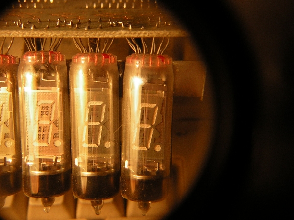

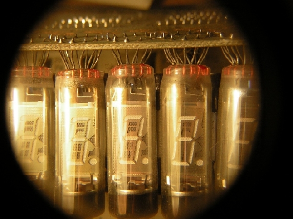

#2 These are in an old desktop calculator. They are pretty cool looking. ;) Are they good for anything? Is there a name for them?

#2: **broken link removed**
Vacuum Flourescent Display
Hey, looks like a variant of:

- nixie tube display

- nixie tube display ...... well, i would say small flourescent numicators,
they have small filaments above the indicators, don't know their proper
name, but i dont think they're called nixie tubes.

Curiously ive never seen them with the extra middle leg ...
i wonder if its independant, i have some somewhere,
i think i will have a look at them, just in case mine have it too.
Interesting.
John :)
#2 is definitly not a nixie tube. As was first stated looks like an old Vacuum Florescant display.
A nixie tube has 10 cathodes, each in the shape of a digit. A nixie tube does not have the obvious 7 segments as can be seen in pics calc1 and calc2.

The glowing parts are anodes.
The filament is also the cathode,
a separate cathode would be in the way visually.
I still haven't found their proper name.

The 7 segment displys are pre the LED area and i think that these are the low voltage vacuum fluorescent displays.
These were common in the late 70's type calculators after the Nixie tube stage.
These have a type of heater element in them , similar displays were also used as VU meters on earlier type of tape decks.
These have a light bluish glow or apple green.

I found this page: http://www.vintagecalculators.com/html/calculator_displays.html
Which has a section on "Vacuum Flourescent Displays" (VFDs)
and that would appear to be the proper name for these devices.
The early ones had an extra short segment to make the fours look better.
Those ones with that extra bit were the first generation of that type,
i presume that the seven segment display became more familiar after a
while, and the extra bit was discontinued.
So they are called VFDs.
As has already been mentioned.
I had thought that term, VFD only referred to the multi function display
units like in old VCRs, but apparently it also refers to the individual
seven segment display devices.
John :)
Nixie tubes are only neon-red, with varrying shades of orange attributable to differing amounts of added mercury. If it's green it's an early VFD
