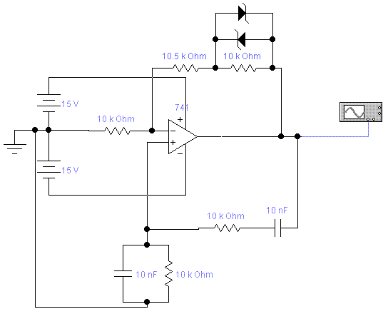

Now I'm having problem to understand the Wien Bridge Oscillator with amplitude control. I've made the circuit as shown in the attachment. The 10.5kOhm resistor is a variable resistor to control the amplitude. At this resistance, the amplitude of the sinewave is very small.
My question is, before approaching 0.7V, the diodes are not conducted and hence, total feedback resistor is 20.5kOhm and the gain is more than 2. But when the amplitude of the waveform is larger than 0.7V, the diode in forward biased is conducted, so the total feedback resistor is only 10.5, the gain is less than 2. I thought it will stop oscillating.

A conducting diode has resistance. Its voltage drop is nearly always the same so its resistance changes with the amount of current flowing in it. With low current then its resistance is high so the gain of the opamp is high. With higher current then its resistance is lower so it clamps the max voltage swing of the output of the opamp.
The frequency-determining parts are resonant so the output level takes time to change. When it starts to become too small then the resistance of the diodes increase and causes the gain to increase so that the output begins increasing in level. The opposite occurs if the output level begins to increase too much.
The diodes cause the sine-wave output to have a flat top and a flat bottom. This creates harmonic distortion. Other methods of level control don't produce so much distortion.
The waveform is distorted only when the total feedback resistance is more than 28kOhm (my simulation result). When it is less than 28kOhm, it gives nice sinewave.
I need some time to digest the resistive of the diode..
In a real circuit either the diodes do nothing and the sine-wave fades away to zero, or the sine-wave gets higher and higher until the sine-wave has a flat spot on its top and bottom. You won't be able to adjust it with no distortion and still allow enough gain for it to always start.

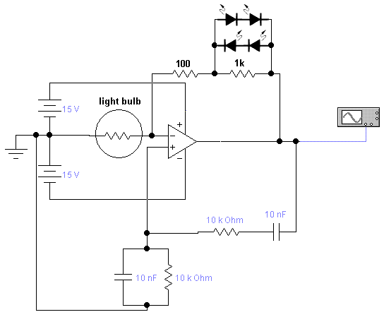

My Wien Bridge tone generator uses the best of both:
1) A light bulb for low distortion level control.
2) Some back-to-back LEDs in series across the feedback resistor to clamp the very high swings of the bouncing.
Only the first few cycles at a low frequency are clipped then it quickly settles to a fixed level.
I tried a FET transistor automatic gain control and even tried an optically isolated-FET but the distortion was too high or the output level was too low.
What is 'bounce' in electronics?
2 back to back LED's in series across the feedback resistor? Then the LED's will not be conducted? I can't figure out how are them connected.
A light bulb changes its resistance when its current changes. When it is in the negative feedback loop of the opamp of an oscillator then it controls the amplitude. But its reation time is slow (which allows very low distortion) so the amplitude bounces too high, then too low, then high again then low again for many bounces.
In my Wien Bridge oscillator I used LEDs instead of your diodes and I used two in series for a higher diode voltage. The LEDs stop the output amplitude from going too high during the bouncing so it doesn't bounce as much.

The resistance of the light bulb changes with changes in the average current in it from the signal. It changes slowly because it takes time for it to heat up and to cool down. If it changed quicker then it would cancel the signal at low frequencies.
