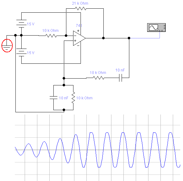

I'm currently learning Wein Bridge oscillator, start from the one without amplitude control. From simulation, I can get the expected result. But when I did experiment, it didn't work. The CRO shows nothing, just a flat line. Even I've increased the feedback resistor to be more than twice of R1.
I think I know what's the problem, it is GROUND. From the attachment (red circled), if the GND is not connected, the output is flat line. But how should I connect a GND in practical? There is no GND with the power supply.

You're confusing yourself with 'ground', 'chassis' would be a better word, as it doesn't need to be connected to 'ground'. The chassis connection is just a reference point that connects to the chassis (if there is one), and is grounded (if applicable) - for a real scope (just as in the simulation) the chassis of the scope should be connected to the chassis of the oscillator.
One obvious omission in your circuit is decoupling capacitors, place them from +ve to chassis, and -ve to chassis, as close to the chip as possible.
Look in Google to learn that the gain of a Wien Bridge oscillator must be more than 3. So in your circuit the feedback resistor must be more than 20k.
Two power supplies are shown in your circuit with the circuit's ground connected beween them where they join. There is a positive 15V power supply and a negative 15V power supply. The circuit should work if two 9V batteries are used.
The circuit can be redesigned to use a single power supply.
When you tried the circuit, what was its load? An opamp can't drive a load that is less than about 2k ohms.

Chassis? You mean the chassis is between the + and - of both the supplies? But the CRO and the oscillator are common grounded (not shown in attachment, but yes they are).
The end of the frequency selective network and the end of R1 is also grounded, should they be connected between the - of the top and + of the bottom supply?

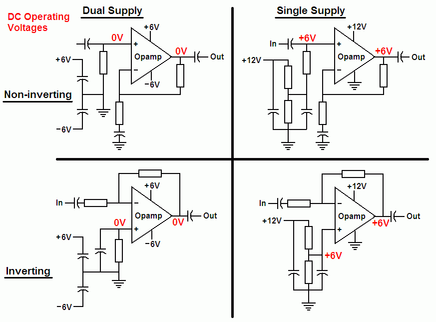

I thought only norton op-amp is using single supply?

Of course the two power supplies should be connected together and to ground exactly as shown on the schematic.
What is decoupling capacitor?
A big filter capacitor across each power supply. They are very important if batteries are used because batteries have an internal resistance.
Any opamp circuit can have a single supply. Simply disconnect the non-inverting input resistor from ground and connect it to half the supply voltage, then add a capacitor in series with the feedback resistor that went to ground.

That's my problem, usually for only single supply, those need to be grounded are connected to -ve terminal. But for bipolar power supply, those need to be grounded are connected between 2 power supplies right? That's what I've done but still can't get the result.

The conditions for oscillation, that the gain should be equal to three and
that the phase shift is zero, are only true if both 10k resistors and both 10nF capacitors are exactly equal ! Try increasing the loop gain, increase the 21k resistor to 22k or 24k. If you would have used smaller capacitors, the stray
capacitance of the circuit should also have been compensated as well.

That scope isn't grounded, connect both of the dots on the right hand side to ground.

Don't you have two power supplies like on the schematic, a positive power supply and a negative power supply?
Don't you have the two power supplies connected in series and where they join together you connected to the circuit's ground, like on the schematic?
Yes, I do have 2 power supplies as in the attachment. But I don't know where should I connect their joint to. Or their joint is known as GND?
When doing other experiment with only single supply, the -ve terminal is always known as GND, but for bipolar, I don't know where should those should be connected to GND connected to.

Of course where the two batteries are joined is connected to the circuit's ground. Look at the schematic. The 'scope is also connected to the circuit's ground.
The schematic shows what is connected to the circuit's ground as explained above. If you connect the -ve of the negative supply also to ground then the negative supply would be shorted.
I've done Wein Bridge Oscillator, it works!!! I think the analog lab unit I used previously is not working well, that's why I kept finding where the hack is the GND.
