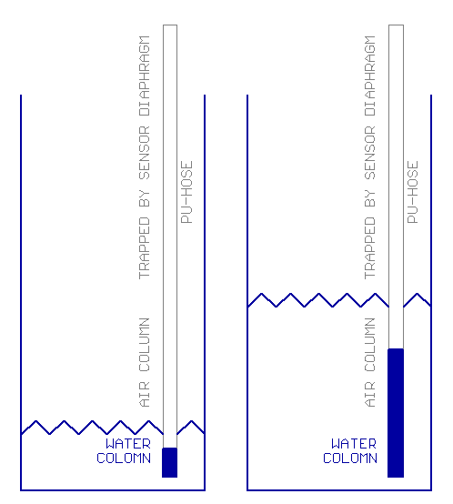

here is an approach to measure tank level using air pressure.
This circuit uses a Motorola MPX2050DP differential pressure sensor.
Measuring pressure has the advantage that the sensor can be placed far away of water. It just requires a 6mm (outer diameter) polyurethane hose (as used for pneumatics) to be inserted to the bottom of the tank.
To compensate for possible air losses you might connect a three way valve to blow air through the hose until bubbles rise. This can be done at monthly intervals. The sensor can withstand a pressure of 200KPa without damage.
The air pressure method works great, but I've always seen them with the water bubbling constantly. All that is required is a cheap aquarium air pump throttled with a needle valve. Just enough to keep a couple bubbles a second or so. Then use one of these ==> PTD25-10-0100WCH Products
teed off the line, 0-10V output. Simple and rugged.

Wrong! The air only has to bubble if is lost somewhere between sensor and water tank buttom to take it to the level corresponding to water pressure. It might (or part of it, nitrogen) also diffund into the water.
The water pressure compresses the air according to its height. Therefor it is important to dunk the hose into the water without pressure losses since the compressed air inside the hose is equivalent to the water pressure.
Even with a little bit of water in the tank (just covering the end of the pressure hose) pumping air with excessive pressure into the hose will indicate an almost full tank.
Also a differential pressure sensor compensates automatically for local air pressure variations by leaving the negative side of the sensor unconnected (access to ambient air).
Boncuk

No, not wrong.
Dunking the hose into the water will not result in the true hydrostatic pressure at the bottom of the tube. Extra air must be added to the tube.
If you start with an empty tube and dunk it, the air will compress as the bottom of the tube is submerged and some amount of water will rise up into the bottom of the tube, The pressure reading will be low by a value equal to the height of the water column in the bottom of the tube.
You could calibrate so this pressure represents a full tank, but you will be susceptible to error from temperature changes and, to some extent, gas dissolving into the water column.
