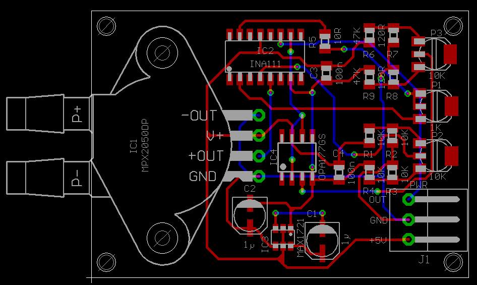

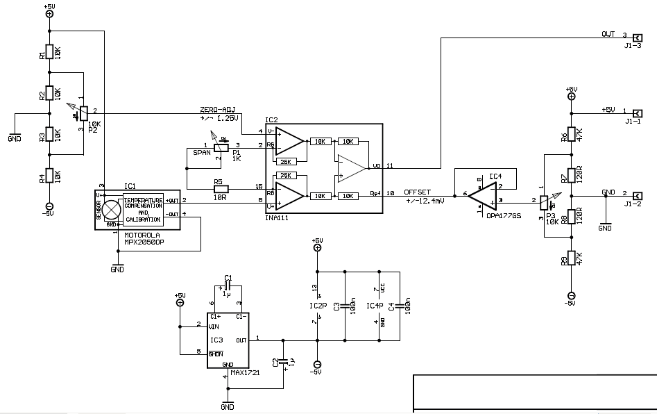

here is an approach to measure tank level using air pressure.
This circuit uses a Motorola MPX2050DP differential pressure sensor.
Measuring pressure has the advantage that the sensor can be placed far away of water. It just requires a 6mm (outer diameter) polyurethane hose (as used for pneumatics) to be inserted to the bottom of the tank.
To compensate for possible air losses you might connect a three way valve to blow air through the hose until bubbles rise. This can be done at monthly intervals. The sensor can withstand a pressure of 200KPa without damage.
The circuit uses a precise instrumentation amplifier (INA111) and the necessary circuitry to compensate for sensor offset (sensor offset at zero pressure ±1mV).
For amplifier offset there is an output offset correction circuit using an OPA177GS wired as unitiy gain amplifier.
The amplification can be varied in a wide range with amplification factors of 49.5:1 up to 5000:1 (sensor output voltage 40mV at full range and a linearity error of ±0.25%) and be adaped to any pressure, not to exceed 50KPa (range 0-7.5PSI)
The board supplies its own negative voltage by using a MAX1721 voltage inverter.
The PCB including the sensor has a size of 1.85X1.32inches.
