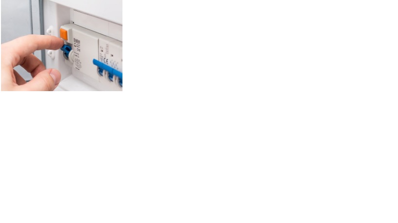

When my washing machine (7 year old ) was running yesterday it trip the breaker ( that one ,first on the left , RCD i guess?!) and no power in home. We reset the trip and the same happened twice more (took me a ittle while to realise it was the washing machine!). The socket is OK, and I presume the fuse in the plug must still be OK as the machine worked for a a couple of seconds before the fuse went again.
That one :

There's a lot of confusion caused here by calling it a 'circuit breaker' - there are essentially two options, either an MCB (fuse) or an RCD (earth leakage trip).
In this case it's the RCD, which is tripped by a leakage to earth. A washing machine would be a prime cause of this, as it mixes electricity and water, a slight water leak inside could easily trip the RCD.
I've had this twice, both times the wiring harness that comes down the front of the machine had rubbed through grounding one of the wires taking out the elcb.
