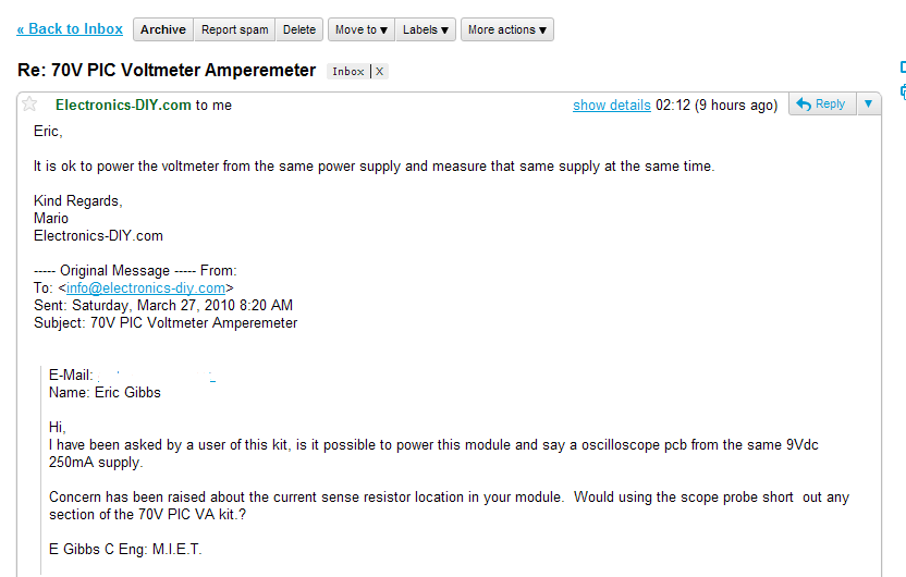

Well,... did not really expect all of that. So I am going to use the single wall wart for power but not use the different meters at the same time. That way there is no risk of messing anything up.. would that be OK?
You're fine using different meters at the same time as long as they're used on different circuits with separate power supplies, i.e. each circuit has its own wall ward or battery powering it and they're not connected to one another.
You also shouldn't use the current meter to measure a circuit connected to the same wall wart used to power the meter but the 'scope is fine as long as you don't connect the ground to anything other than 0V.

hi Hillbilly.
This image is shows my email and the suppliers response, they agree its OK to use the scope and the V/A module.
I suppose if the supplier says it's fine then go for it, then if it goes wrong you can at least blame them. :D Maybe it's a good idea to ask for yourself, then you have first hand information from them.
