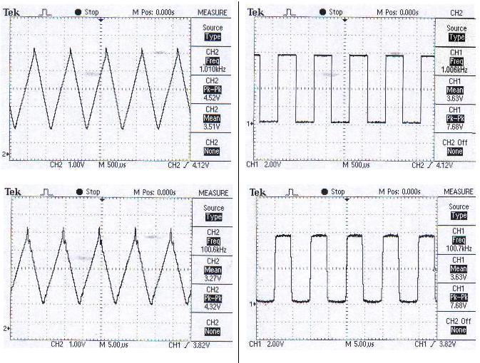

This time, i followed the resistor values in the application note. i just exchange the R18 & R19 values. I got the Triangle!
Can anyone tell me what is happenning?
If the IA is working correctly, the triangle output should be symmetrical around zero volts. Is it?
Hi Ron,
May i ask why at higher frequencies, the waveforms will be distorted?
How does the IA works to get the triangle wave? Is it differentially amplifying the capacitor waveforms?
