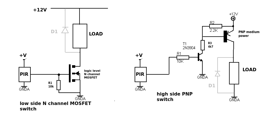

I have a dc motor which runs at 3-12v at around (peak) 50mA.
I want to switch the running voltage from 12v to 9v to 3.3v (without using PWM).
I draw up a cct using 3 NPN transistor? But it doesn’t seem to be doing what I want?
Does anyone know what is the best way of doing this?
Sorry, that cannot work; two reasons:
The transistors are in "emitter follower" configuration, which gives current gain but no voltage gain; the emitters will be at around 0.6 to 0.7V below the base voltage regardless of collector supply.
And, you cannot supply a motor from a resistor divider laike that and get a stable voltage; ie. R4 would only pass 4mA if directly shorted to ground.
The motor current will depend on its speed and loading.
To drive a voltage to grounded load from a supply voltage above the logic level, you need two transistors; the first switching to ground, and that switching a PNP or P channel FET with it's emitter or source fed from positive, and the base or gate of that fed via resistors from the collector of the first transistor.
With two or more different voltages feeding the same load, you also need a diode between each PNP collector and the load (motor) to prevent "back feeding" from a high supply to a lower one.
Edit: Thinking about the motor voltage & current requirements, you could use three switch circuits all supplied at 12V, and a couple of eg. 1.3W zener diodes in series with the appropriate transistor switches to drop the voltage at the motor. A 2.4V and an 8.2V zener (in conjunction with the anti-backfeed diodes) would give around 9V and 3V.
See the right hand half of this example, the high side PNP switch:
Thank you. I realised the issue with back feeding and put some Diodes in to stop that. But your right with the motor voltage via a pot-div, cannot get it to work.
I changed to relays instead, seemed abit more robust, but now need to look at the voltages and how to get the 12, 8 and 3.3v.

No; the zeners mnust be in series to reduce the supply by that amount. Having them across the supply would cook something, either the zerer or the PSU.

That looks fine!
Don't forget flywheel diodes across the relay coils as well as the motor, when you build it.

They are in series with a motor that the OP has stated draws a maximum of 50mA. That's less that 500mW on a 9V zener; I advised 1.3W types to allow for startup and moderate overloads.
To be honest, this whole idea is pretty nasty :D
If he's not doing it 'properly' by using PWM, he may as well do it the tried and tested crude way with simple wirewound resistors switched in series for the different speeds, as car heater fans did many decades ago.
