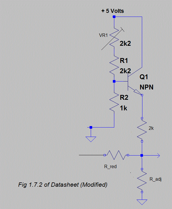

I need to provide exact voltage 0-1v to control current through a driver IB462H with the picture of the page below. I am hesitant using resistors to control the voltage since the output voltage may change if there is a variation in the current.
all the voltage regulators I found start around 1v and up. is there a regulator or another solution to that would output <1v? Easily adjustable regulator will help since I may change the voltage time to time (for 1.2amp vs. 2amp motors) but more "permanent" solution will be fine too.

An LT3082 regulator should do what you want.
Otherwise you could use a more common regulator, such as an LM317, which has a minimum output of 1.2V (with the ADJ terminal connected to common), and use a pot at the output to adjust the voltage to your stepper from 0V to 1V as desired.
See attached schematic. It is the modification you need to make to the schematic given in Fig 1.7.2 on page 30 of the IB462H datasheet. Adjust VR1 to get 1V between the emitter of the NPN transistor and ground. The rest of Fig 1.7.2 remains the same. The npn can be any general purpose type eg 2N3904, BC239 etc.

I love the LT3082 BUT I just noticed it does not work well with less than 500uA load. It will not allow less than 0.5 volt output with out this minimum load.
What current? The current on the current adjust pin?
The current adjust pin is not stated in the data sheet but I think it is about 10uA. The resistor divider has a impedance of 50 to 1000 ohms and will not be effected by 10uA.
I think you are OK with just a resistor divider.
