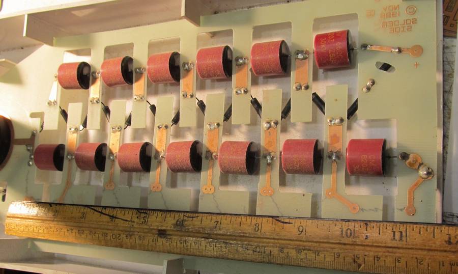

This is the biggest Multiplier I Built.
Output Over 130 KV.
This whole unit was summerged in Transformer Oil for Insulation.

I built all of this unit about 20 Years ago, for another company I was under Contract for.
So because of Time, my memory is lacking a bit on some details.
It was driven with a High Frequency Switching Power Supply, that I also designed.
I believe it was rated at about 800 watts.
The Output Transformer I made for it was also Oil Filled to prevent Corona discharge.

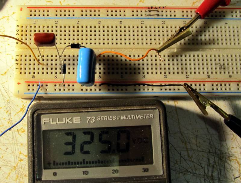

The Diodes I used are 1N4005's
Brown Cap = .02 uF
Blue Cap = .43uF
Input was 120 VAC
Output is Not Quite the 336 volts, but Close to it.
There are always some Losses because of Diode Voltage Drops and Filtering.

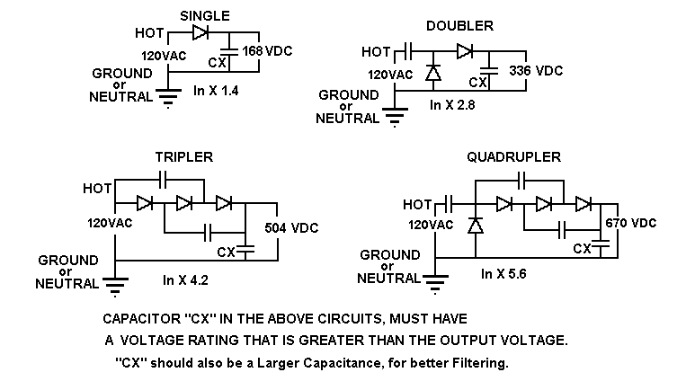

I did not check the others, but the voltage doubler schematic is wrong.
The first diode prevents charging of C1 to negative voltage.It should be replaced by wire.
Also in your working circuit you have only two diodes.

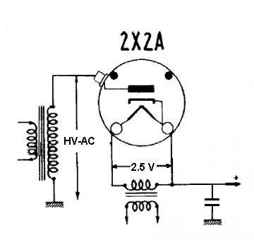

Ok so I want to operate vacuum tube using my multiplier circuit. I have 2x2a tube, which is a half wave diode. There is one anode and one cathode. There are a total of four pins on the bottom two of which are not used and the other two are heater pins, one of which is the cathode. Please see attached file about tube. I am trying to operate the tube in cold cathode mode. I know the positive output of the multiplier will attach to the cap(anode). I am not sure what to attach to the cathode or the heater pins, will I attach the negative output of the multiplier or ground it?
  • 2X2-A.PDF
Ok I think I have it working. I attached the hv positive to the anode and hv negative to cathode. I tried it out with 15 kv dc and got a faint blue glow.
So next I want to find out in the diagrams you posted above you said the cx(last capacitor) needs to be rated higher than the output voltage. So in my case I need a 40 kv cap because my output should be 38 kv. How crucial is to have it at that rating? Is it possible to use two caps rated at 20 kv each to get 40 kv. So based off this in the multiplier you made, was your last cap rated at 130 kv or did you do something else?
