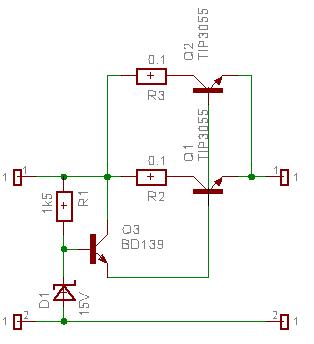

I designed a circuit. I could allways lead the excess warmth to my ass :)
Errors? other mistakes? I'm not sure about the 1k5 resistor, will it drop the voltage to much under load? should i add one more buffer stage?
It's a simple series regulator, your only mistake is the two 0.1 ohm resistors, they should be in the emitters of the two power transistors.
However, it has the disadvantage that it will always waste some power, the Triumph zener diode circuit I mentioned previously was a parallel regulator, and didn't waste any power until it had to.
