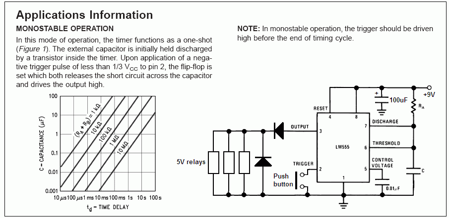

Hi George,
A 555 will switch all relays off at the same time. Its datasheet is here:
It will draw 4mA to about 10mA all the time it is connected to the battery.
Since it needs a series diode to protect it from the flyback voltage spike from the relay coils and since it has an output voltage loss of up to 2.25V,
a 9V battery is needed to power its circuit.
Since most 5V relays are guaranteed to operate with a voltage of 3.75, the circuit will still work when the battery voltage drops to about 7V.
George L. said:
how can I use the 555 timer IC to stop the relays from going off one by one.
thanks,
George
Do a search for 555 and you will find many circuits. Many of them won't be suitable for your purpose, but some may.
Note that there is a CMOS version the 7555 which consumes less power.
If you do this and still need help, send me a PM.
Len
GeorgeL, don't you have your arrow on the transistor backwards? It should be an NPN, right?Wouldn't you want to use a 555 timer IC to do it? Make pin 3 drive one transistor each for each relay via a 100 ohm resistor.
ljcox, you are right when you see the switch closed. But when it is opened, that is a voltage divider in there.
