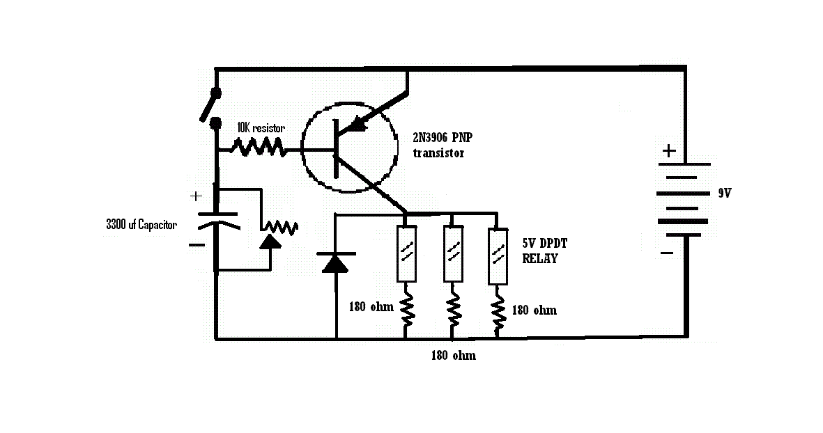

I finally posted it correctly
it it finally ok now?

Hi George,
Your circuit is posted as a nice GIF and is perfect :lol: with the 2N3906 PNP transistor. Don't turn down the pot too low or it will burnout and kill the battery when you close the switch. Also don't use more than 10 relays and their 180 ohm voltage-reducing resistors. :lol: :lol:
You can get relays with many more contacts but they draw too much current. What are you going to drive with the relays? Usually we use transistors, Mosfets or triacs to drive loads and they don't use the high operating current and last much longer than relays.

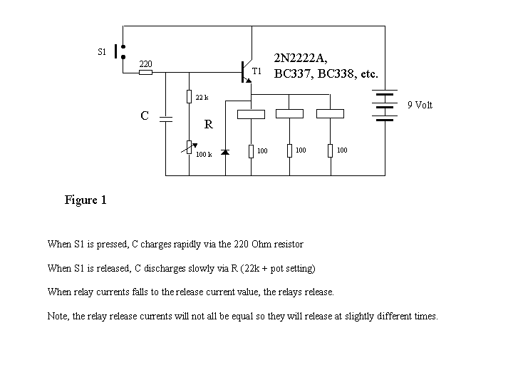

George,
The posted circuit has 2 issues:-
1. The time delay will depend on the hFE of the transistor. hFE varies from one transistor to another and also varies with temperature. So the time delay will vary significantly with temperature. Because of these factors, it is also difficult to calculate the time delay.
2. For a reasonable time delay, the capacitor will have to be large.
The circuit below virtually eliminates the hFE issue since the transistor is in the emitter follower configuration and so changes of hFE will not affect the time delay. And, for a given delay, the capacitor can be significantly smaller.
Len

could you please explain your circuit, it is similar to mine(i think)
i don't get the 22K resistor and the 220 ohm resistor

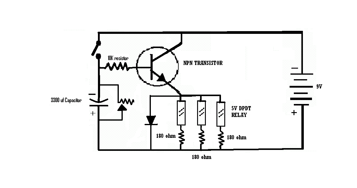

I would like to us a NPN trasistor in my circuit because after some lerning a bit about transistors, a PNP is more more confusing. I am a TOTAL newbie :oops: :oops: :oops: :oops: :oops:
is the circuit attached correct?

No George,
Compare your circuit to Len's last circuit that is the same. Your battery's "+" and "-" symbols are wrong again, the capacitor and diode are backwards again, the base resistor's value is much too high and the relay voltage dropping resistor values are too high. :cry:
audioguru said:
No George,
Actually I would suggest that he's simply got the collector and emitter of the transistor the wrong way round - and drawn the entire circuit upside down, compared to the conventional way!.
Plus the wrong resistor values!.
