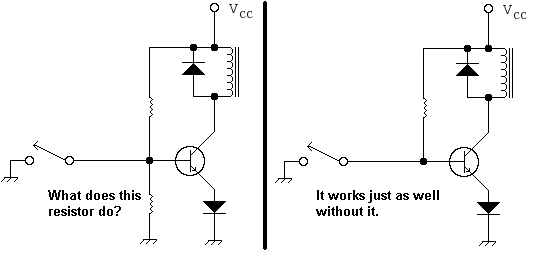

Here is a simple relay driver that will operate with greater efficiency.
To design, you need to know the relay coil current. This will become your collector current. The current through the bias resistors should be selected to be: I(bias)= [10 X I(C)]/h(FE). The voltage at the base is: 0.6 + 0.7= 1.3V. This will be the voltage across the lower bias resistor. The upper resistor simply absorbs the excess voltage from V(CC): V(CC) - V(base).
This circuit won't waste power as would using a droping resistor in series with the coil. Closing the switch will open the relay, and vice versa.
Hope this helps. :)

The resistor between the base and gnd is not necessary in this case since the switch shorts the base to gnd when closed.
Len

The circuit also doesn't make any sense?, it's dropping the entire supply voltage (minus the Vce of the transistor and 0.7V drop across the emitter diode) across the relay. So effectively all it's doing is putting a diode in series with the relay coil and dropping 0.7V?.
I 'suppose' by carefully selecting the base feed resistor you could only turn the transistor partly ON, but this would dissipate the excessive heat inside the transistor, most probably causing it to fail?.
Miles Prower said:
This circuit won't waste power as would using a dropping resistor in series with the coil.
Sorry Miles. It will waste exactly the same power as a series dropping resistor if it dropped the correct amount of voltage, plus a little more for the transistor bias current.
Only a switching regulator wouldn't waste much power. :)

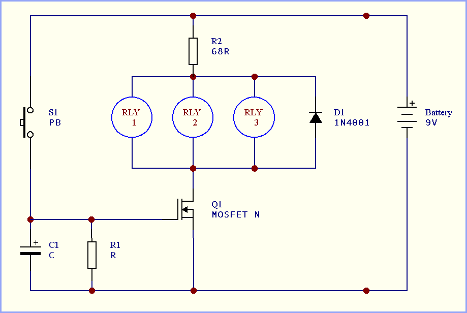

Hi George L.,
To help you in putting the circuit together, I drew up the following circuit which included ideas by Audioguru.
If you tell us the time you would like the relays to stay ON after you release the push button, Audioguru can quickly tell you what the value of C and R to use as he loves RC time constant. :D :D

Having designed many electronic/relay interfaces, I can assure you that the circuit does make sense. The relay is operated when the switch is open - provided there is enough base current to saturate the transistor.
Len
I agree with Nigel.

since I don't know if eblc1388's diagram is correct, I thought I would draw out Audioguru's suggestions. The diagram is attached. I am trying to keep the potentiometer because I may need to adjust the amount of time the relay stays activated.
Will the attached circuit work, and also will it work with up to 5 relays.
Thanks,
George
  • circuit11111111111111.doc
Sorry George,
I could tell that you are a noobie because you don't know anything about voltage, current, resistors and relays.
I didn't realise until now and nobody else did either that the capacitor, diode and battery are all backwards!
I think I said before that each relay needs a series 180 ohm resistor, or all 3 relays can be paralleled then the combination needs a single 62 ohm series resistor.
The 2N3906 transistor is rated for 200mA so can drive up to 10 of your 20mA relays.
George, you picked the wrong type transistor for your latest circuit. You need a NPN type for it to work. Also, you need to make sure the combined current from the 5 relays can be handled by the transistor without overheating it.

Hi Klaus,
A PNP transistor will work exactly the same as an NPN transistor in his circuit, except of course the polaritiy of the cap, diode and battery must be correct.
The transistor saturates so it doesn't dissipate much heat. With the rather high value for its base resistor and more added from the pot, if the transistor barely saturates with a 1V drop, it will dissipate only 93mW when it is driving five 20mA relays. :lol:
