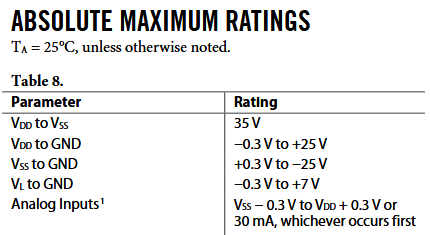

Voltage applied to multiplexor pins when multiplexor IC is not powered?

You just need to look at the data sheet's Absolute Maximum Ratings on page 10 (below):
The inputs would blow unless the input current is limited to 30mA if the supply voltage(s) are off.
If the input current is not inherently limited to below that value, a 1k ohm resistor in series with each input should work for 22V maximum input voltage.
That shouldn't have any significant effect on the signal, unless it's very high frequency or the mux output has a low impedance load.
Thanks but the analog switchs may well be off if the adg1438 is not powered......but still we fear 22v may blow the chip if its not powered and 22v is applied to pins S1, S2, etc?
I understand they are not powered.
But the added series resistor will protect them.
Can you add them, as I suggested?
Thanks, but no we cant add these, as we need the path through the analog switch to be low resistance.
I'm wondering if we shoudl put series diodes in there though.....anode to S1, etc
I think there are diodes from the switches to V+ and V- inside the IC. These are only 30mA diodes. When applying power to the pins you will power up all the circuits on the power supply. If the circuits pull less than 30mA the diodes will hold.
Adding dual diodes on the outside does not help much because the internal 30mA diodes turn on first (lower turn on voltage) and the external 200mA diodes will not turn on until you are way past 30mA.
Ron makes a pertinent point: If you can't limit the current with resistance in the signal source, perhaps you can stop the signal source "back feeding" the supply rails to the rest of the circuit via the clamping diodes in the multiplexer. Simply supplying the multiplexer supplies through diodes might work.
