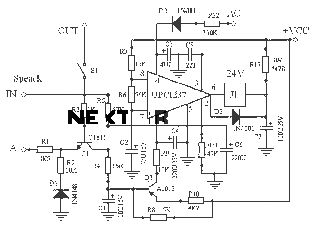

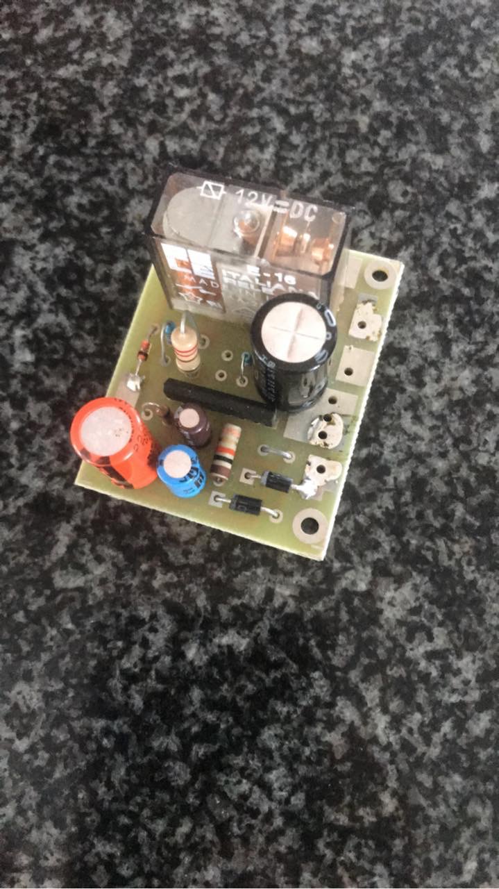

I recently built a speaker protect circuit based around the uPC1237 (photo), but did not make use of pin 1 that has the overload circuitry, as I’m not sure exactly how to use it.
Anybody have a circuit or idea how to add a VI / SOA limiter to these or similar push pull amplifiers. ??
