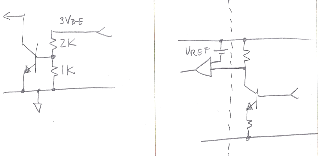

Most of the internet schematics have temperature instability and add too much voltage gain to the loop.
My circuit is not the best at temperature. (Vref + Vb-e) But many internet examples are (3 X Vb-e)
For those why don't know what we are talking about:
When look at a unknown voltage, The circuit on the left is more of a voltage comparitor than a amplifier.
If the input is less than the Base to Emitter voltage times 3 then the transistor is off. More than = on.
We all know the Bbe varies with temperature. The voltage gain of the transistor and phase shift adds confusion to the IC.
The circuit on the right also has a Vbe in it but not 3 X Vbe.
If the two resistors have the same value.....
The input voltage-Vbe is on the bottom resistor and across the top resistor.
We are comparing Voltage-Vbe to the temp stable Vref inside the IC.
There is no voltage gain and little phase shift to confuse the IC.

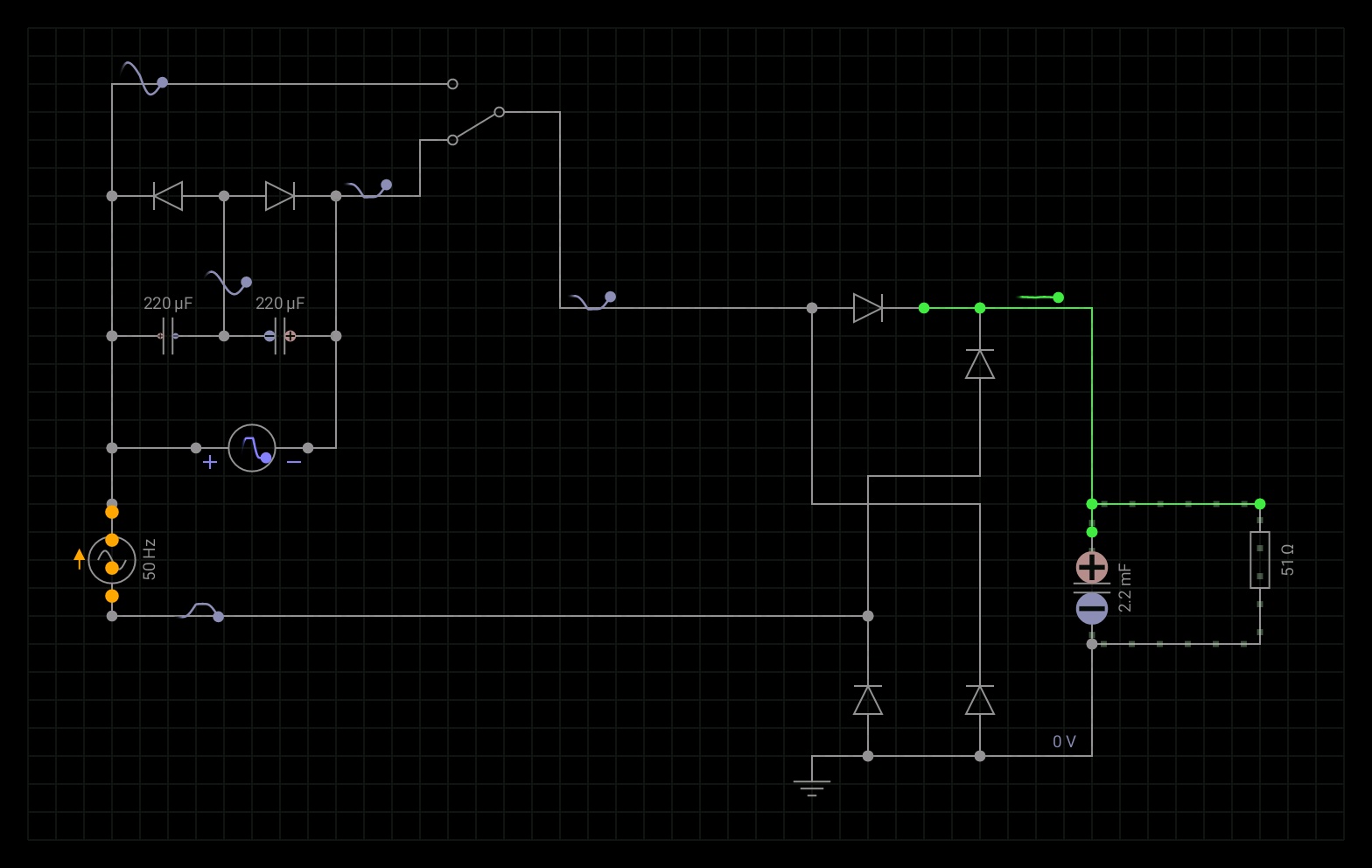

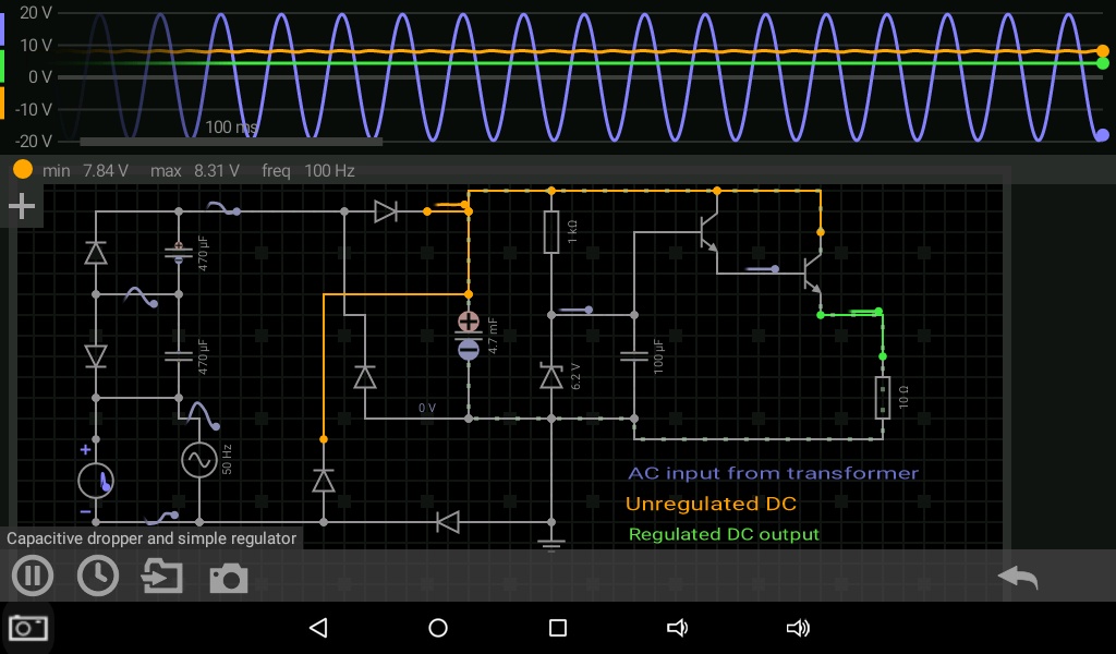

I tried this idea this morning. That is using a capacitive dropper ahead of the bridge rectifier & smoothing capacitor as a crude sort of pre regulator.
In the diagram shown the changeover switch would in fact be the contacts of a relay. At lower output voltages from a subsequent linear regulator ( not shown ) the capacitors would be connected in series between the AC source and the bridge rectifier. At higher output voltages the capacitors would be bypassed giving the full unregulated output voltage to feed the regulator.
At low currents the unregulated voltage with the capacitors in place would be closer to the non capacitor value but as the current is lower, power dissipation would be less of an issue.
I used 3A schottky diodes ( 1n5822 ) to keep the reverse voltage across the electrolytic capacitors to a minimum.
