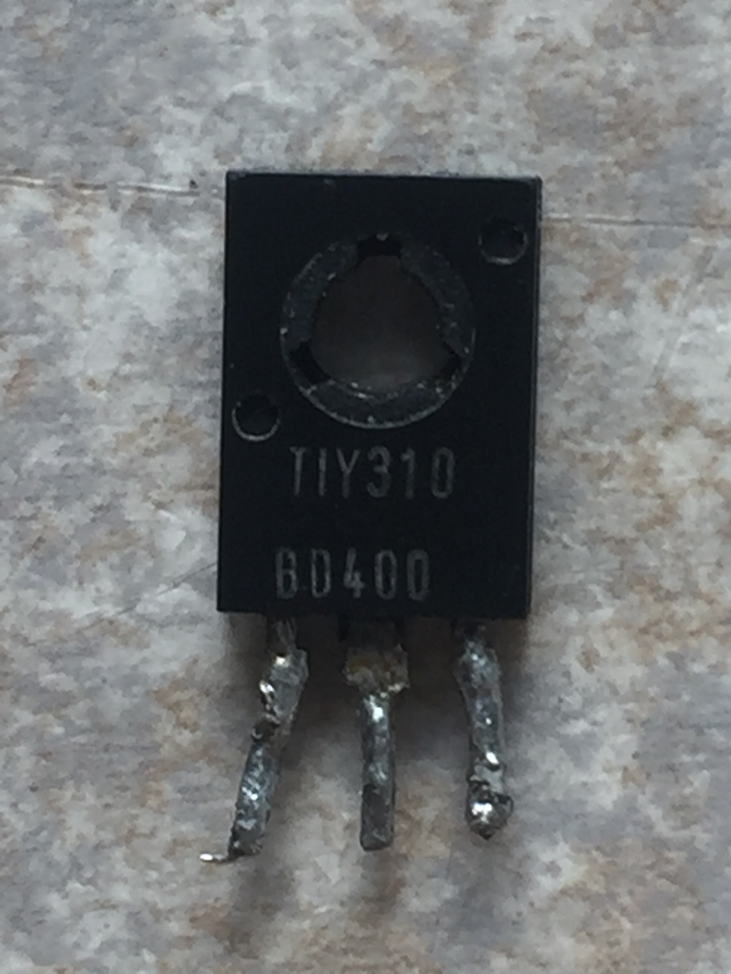

while im checking the t104 i break one of it legs so i took it off to replace it the problem i dont have one on stock i need to order one what could repalce t104 bd137 or bd400 what s the suitable one.
do you les jones think the bd 137 will be the right t104 replace cause i ve got it on the other working radio ?
hello again to everyone hope you doing well, im coming back here i need your lights ,help please with T104 equivalent replacement for this radio.
Is it a round metal can package, or a plastic one with a bolt hole.
hi dr pepper it s it s to126 plastic package i think, i ve uploaded a picture of it also picture of a shematics , it s t104 .

Just a guess so it might not work, however I remember seing a 27mc transmitter that used a Bd139, the package is the smae, not sure about the pinout.
Maybe you ought to get a cheap component tester, you can get them on ebay for very little.

Did you check the data sheets for the original and the Bd137 to make sure they are the same, you might have to 'cack' leg the replacement.
to be honest i did nt checked the datasheet ,i ordered the bd137 i thought that it will work but not.i realised after yhat they are 2 different transistors.
Doesnt mean the Bd137 wont work.
Whats the number of the original again,
ok i ve got some measurements,
i set the multimeter on diode, the reference side of the bd400 transistor in front of me the black side were is writted the ref of transistor.
black probe in the middle leg , red probe in the right legsit reads 0.528
black probe on the left leg the red probe on the right leg 0.543
black probe on the middle leg ,red probe on the left leg no reading
