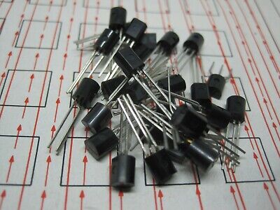

hi dr depper, yes i agree with you the only ones available on ebay are BC547B but not BC547 which is 300mhz,and i think they are not the same.
hi dr pepper bc547b are available but not bc547 ,and i think they are not the same.
The final letter ('b' in this case) simply signifies the gain range of the transistor 'b' is 200-450 and 'c' is 420-800.
When describing a transistor most people wouldn't specify the last letter, and a plain BC547 could have a gain from 200-800.
So same device, simply selected for gain.
thanks nigel in this case i have the 547B inside my box i will try it.

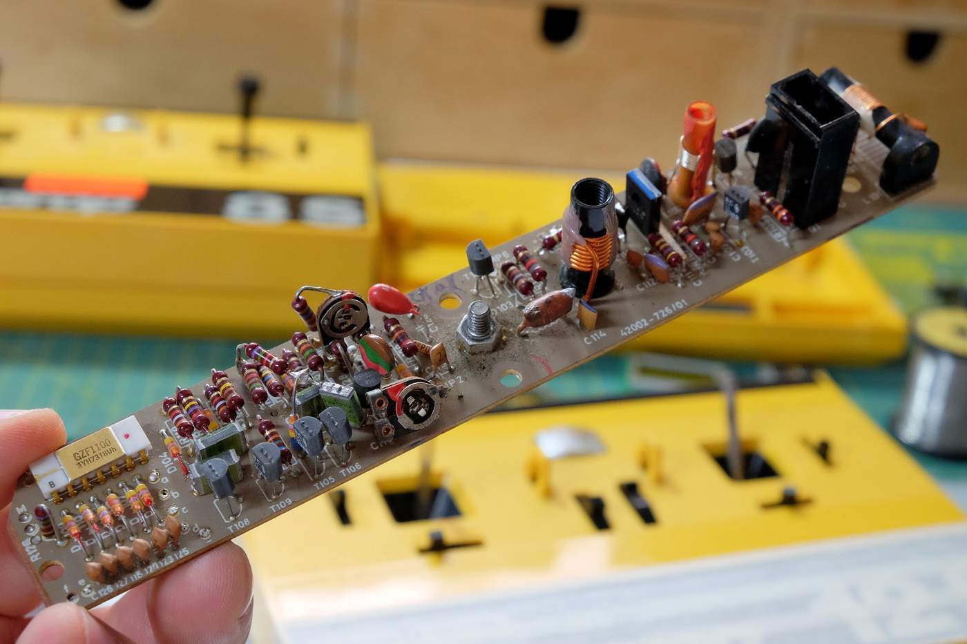

but i have another varioprop12S same yellow one that i want also to repair the problem is i ve plugged by mistake the 12v battery in reverse polarity since then it stopped working , when i switch it on it turns on but nothing more, receiver not receiving anything.
surely one or more components are destroyed i dont know were to start investagating any idea thanks.
Start by looking for burned components. If there are none, see if it is taking too much current. If it is taking too much current, or if any components are getting hot.
Reverse polarity could damage T102, T104, T110 and possibly the IC.
If it isn't taking too much current, and nothing is getting too hot, check the regulated supply between pins 14 and 7 of the IC. You should get around 5.5 V there.
Post your findings after that.

hi everyone ,the IC chip on my board is GZF1100 1YH7318UH , sorry guys i dont know the pineout of that chip. i ve checked with my l multimeter contuniuty mode and i ve noticed that the last pin is connected to the ground but i dont know were is located pin7.
Look at the chip with the notch or dimple in the top of the plastic case to the left, pin 1 is then bottom left.
The circuit diagram that you posted has the IC labelled as a 74164. I have only done a brief check of the connections to the pins. The circuit would seem to work with the SN74164.
The SN74164 has been available since about 1975. I'm not sure if the exact IC is made any more, but the 74LS164 and the 74HC164 are, and either would probably work as a direct replacement.
The data sheet for the 74HC164 is here:- https://assets.nexperia.com/documents/data-sheet/74HC_HCT164.pdf Figure 5 shows the pinout.
Interesting design, it looks like the device is being used as an analog switch.
sorry about the circuit diagram of varioprop12S i ve posted ,my varioprop 12s has a different chip ,but im sure it can be replaced with 74164 IC since all other components of the circuit are similar but i could be wrong.
anyway i ve checked a voltage with my digital multimeter set on DC. black probe touching pin 7 red probbe touching pin 14 it reads 03.93 (when looking at the chip from the top red dot on the right hand side) pin 1 of the chip buttom left pin 7 buttom(ground) right pin 14 upper left.please correct me if im wrong.
just to give you an idea ,i took this picture from the internet but it is similar to my pcb.
