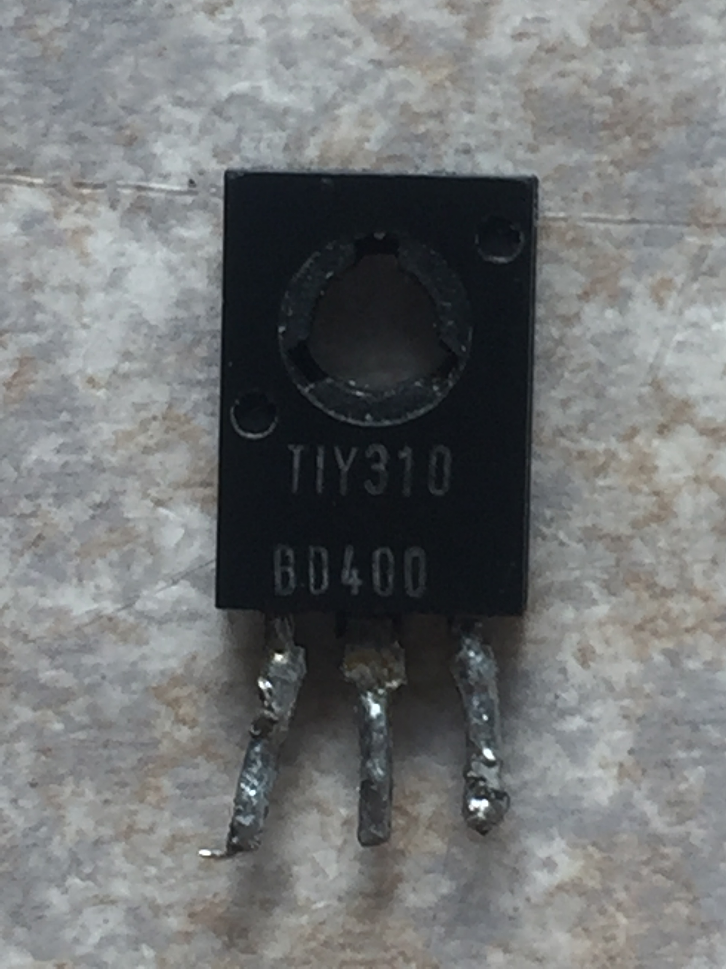

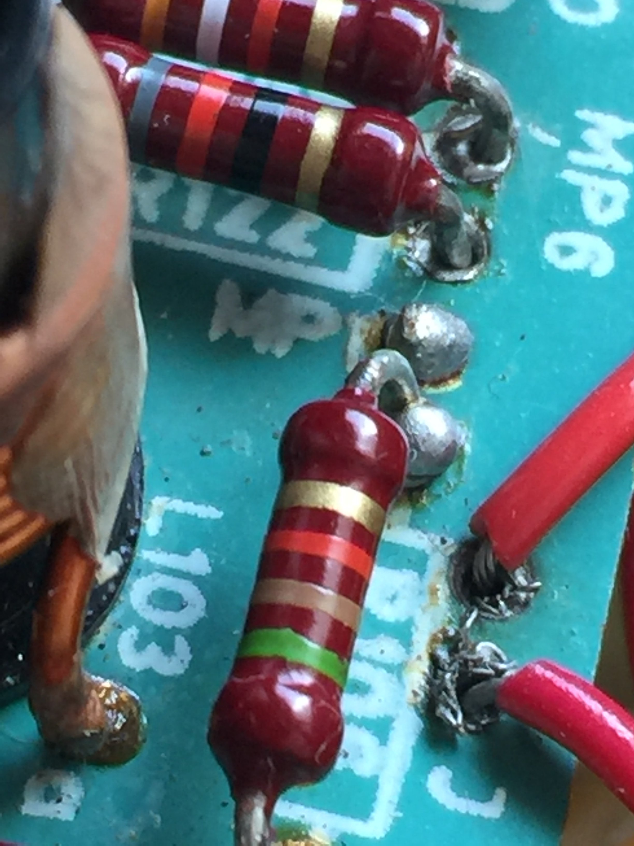

sorry i did nt mention that i ve already changed the diode d103 i put 6.2v instead, i also changed the t1110 with bc238b t102 with bc238b t103 with bc238b also t104 with bd400 why i ve change them because i suspected them ,i did nt mention that the r108 gets very hot before changing t104 sorry about that.
i will post some picture of the pcb

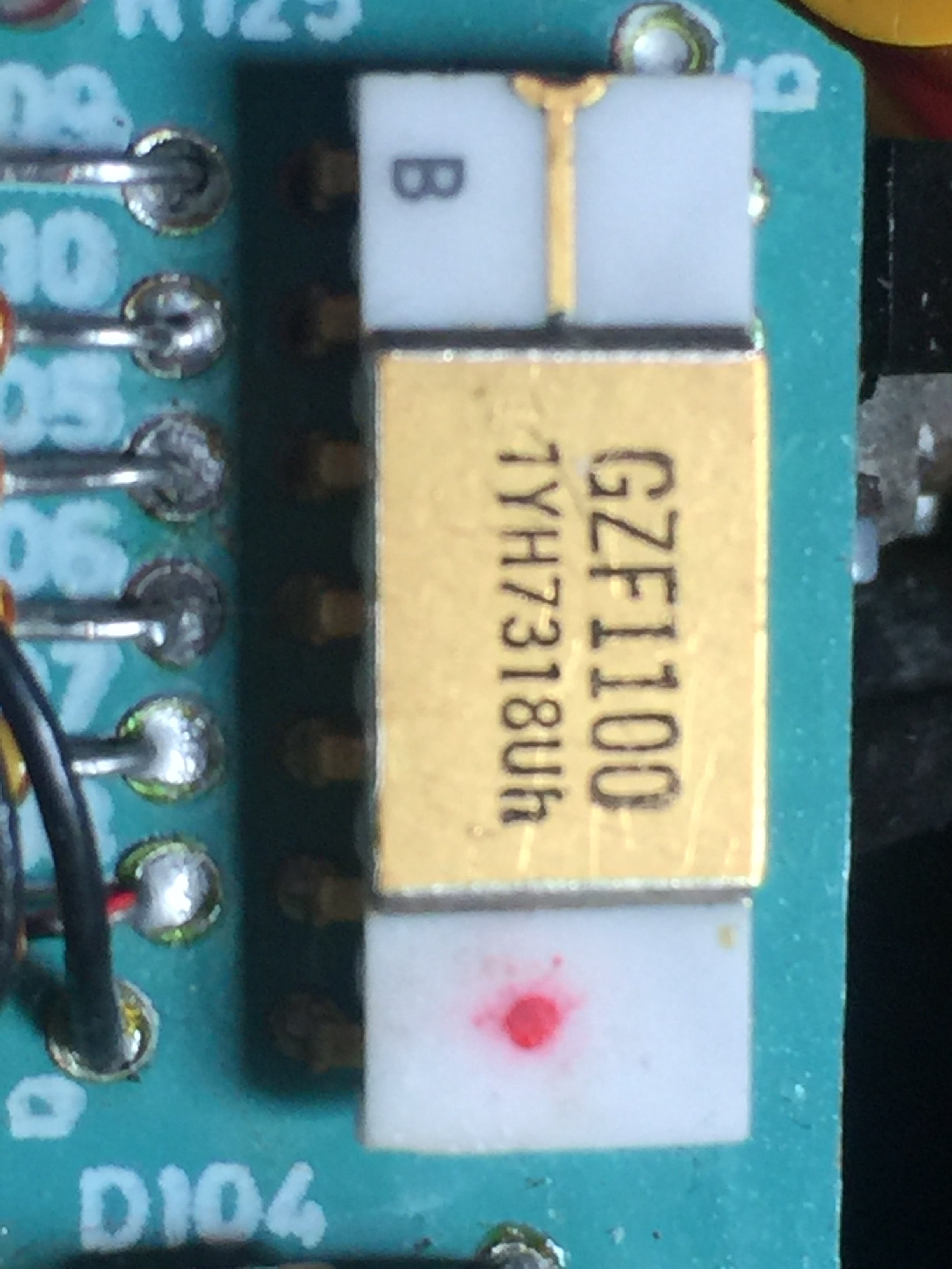

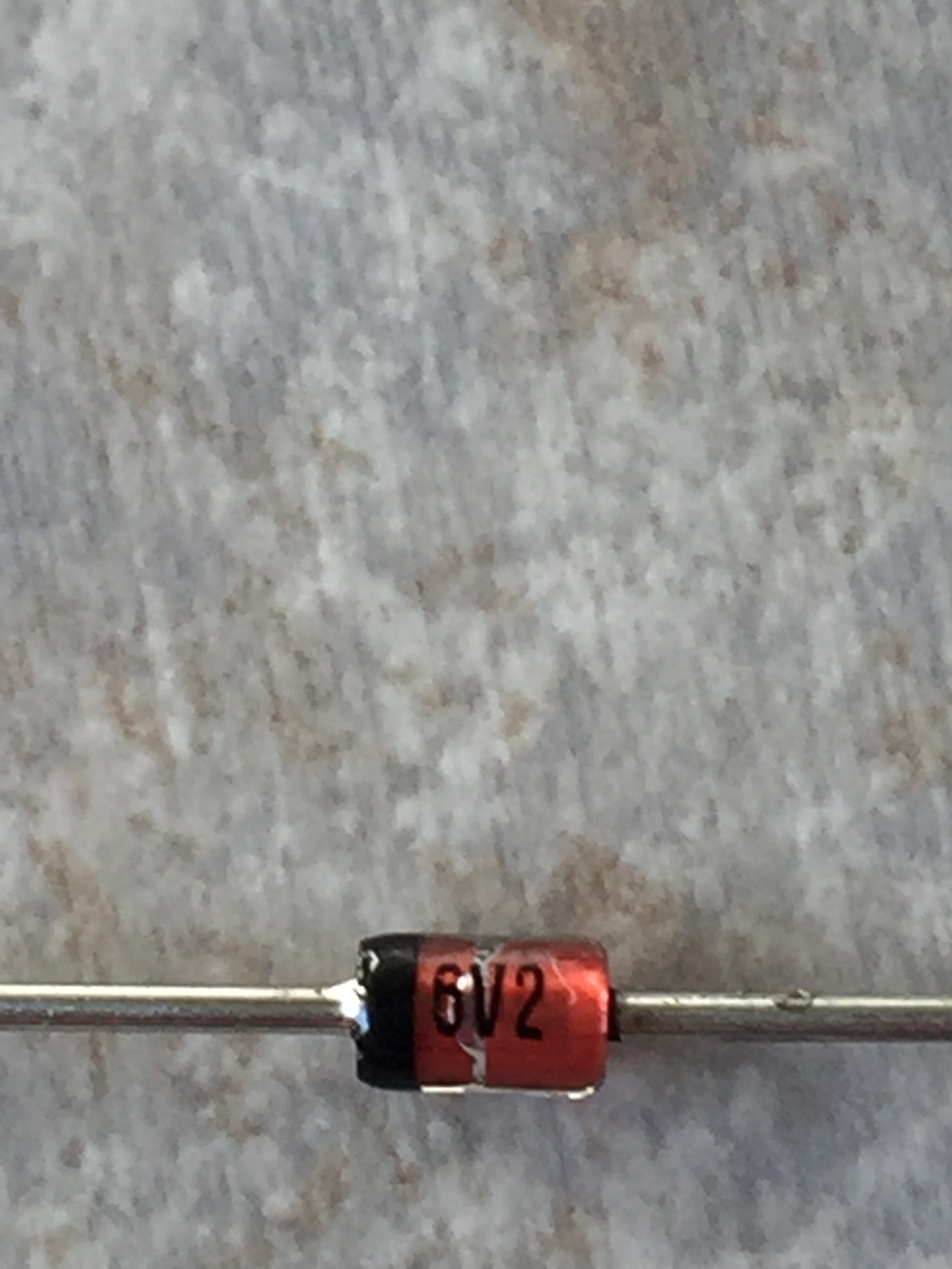

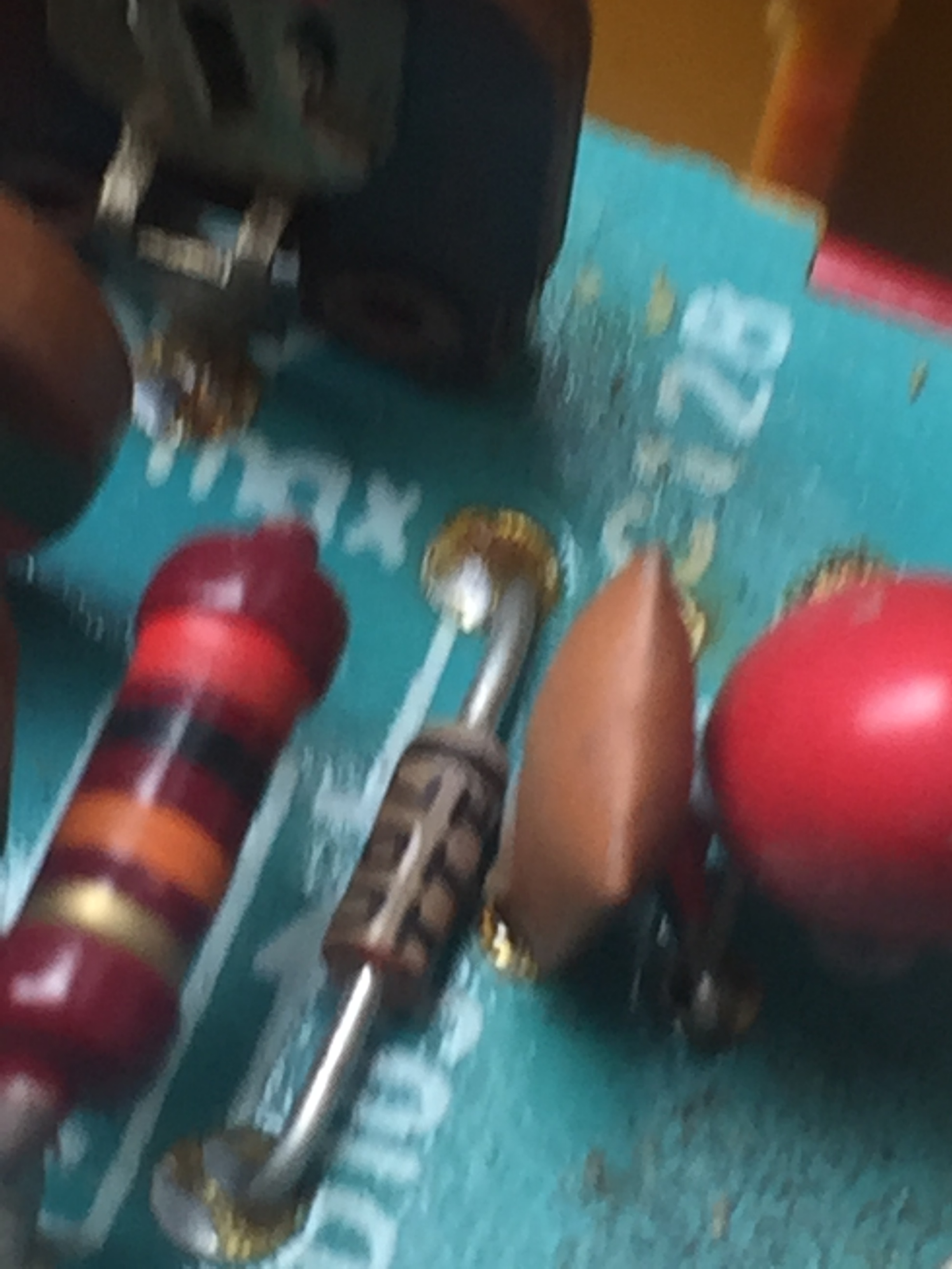

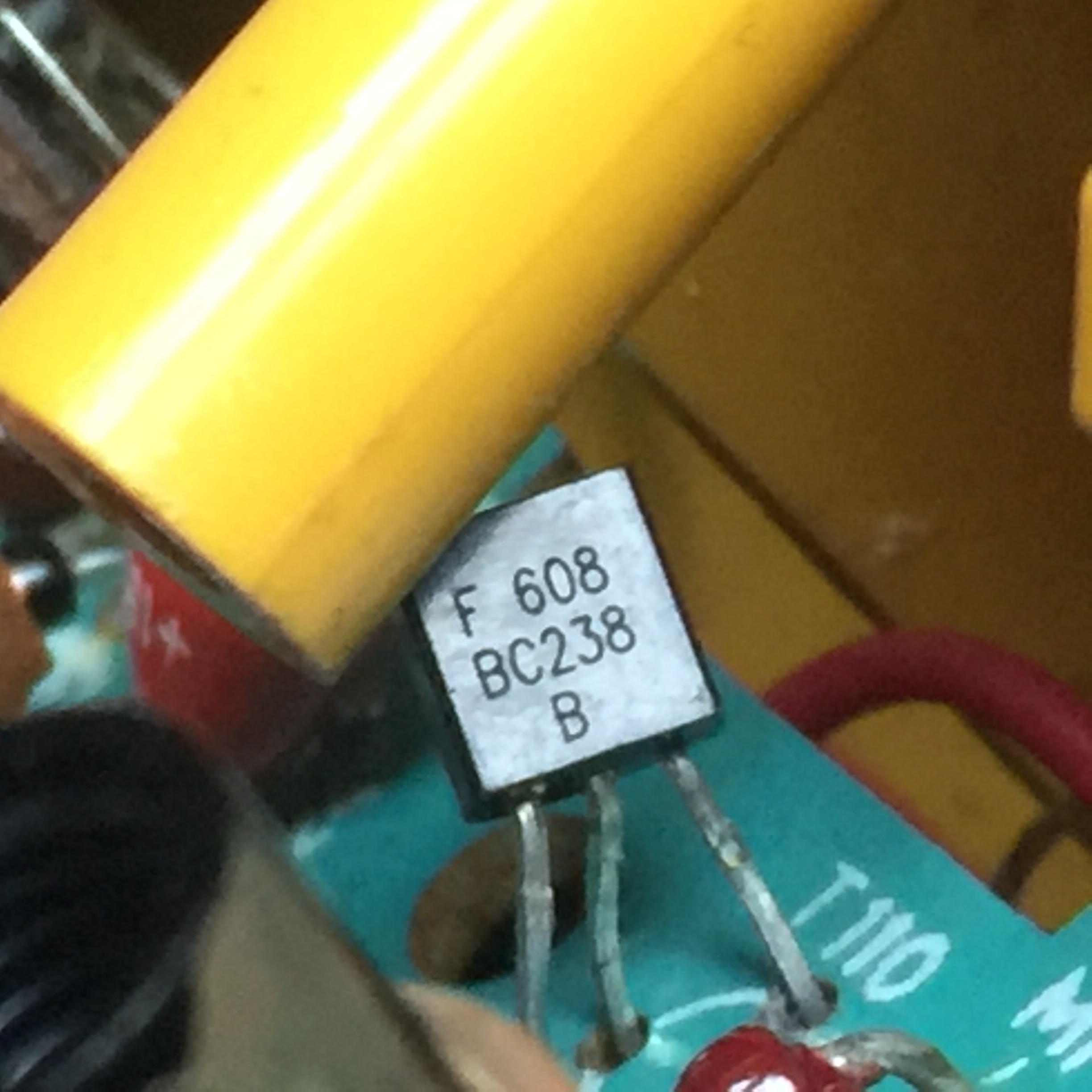

here are some pictures of my pcb as we can see original t104 bd400 that i changed with bd137 , a picture of the original d103 and the new 6.2v diode soldered with a picture of the transistyor i ve changed t103 t102 i replaced them with bc238b
t101 i replaced it with 2n2222 i could did something wrong.

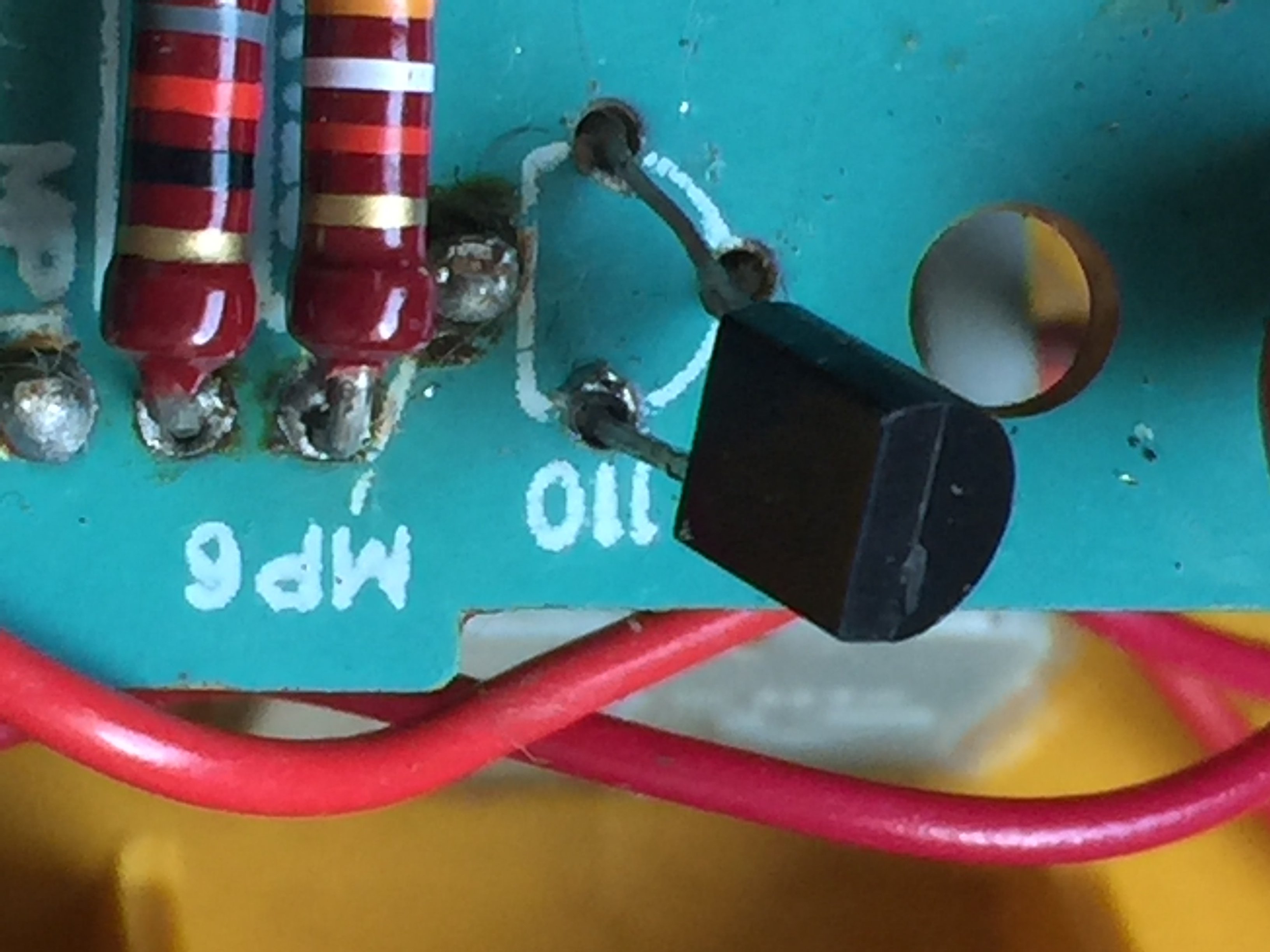

It looks like you have multiple faults. r108 getting hot would have been caused by t104 having a collector emitter short so you ave fixed one fault. (I is possible that it may have also damaged Dr101 in its collector circuit as it would have been passing about 250 mA.) Back to 5.5 volt power supply problem. I assume that when you say you replaced t1110 you mean t110. Can you clarify what you mean when you said "i put 6.2v instead, " (According to the schematic that is what it should be.) As you have replaced D103 and t110 the readings do not make sense. Can you post pictures of that part of the board from both the component side and the etch side so we can check that you have fitted t110 correctly. (D103 must be the correct way round otherwise the voltage across it would have only been about 0.7 volts.)
Edit. I have just seen the picture s that you have just posted.T110 does look like it is fitted correctly. (Unless you used a BC238L which would have a different pinout if it exists.) Can you disconnect the base lead of t110 and re measure the voltage on the top of D103 with respect to ground and also measure the voltages with respect to ground on both ends of r122.

i attached a picture of the t110 .

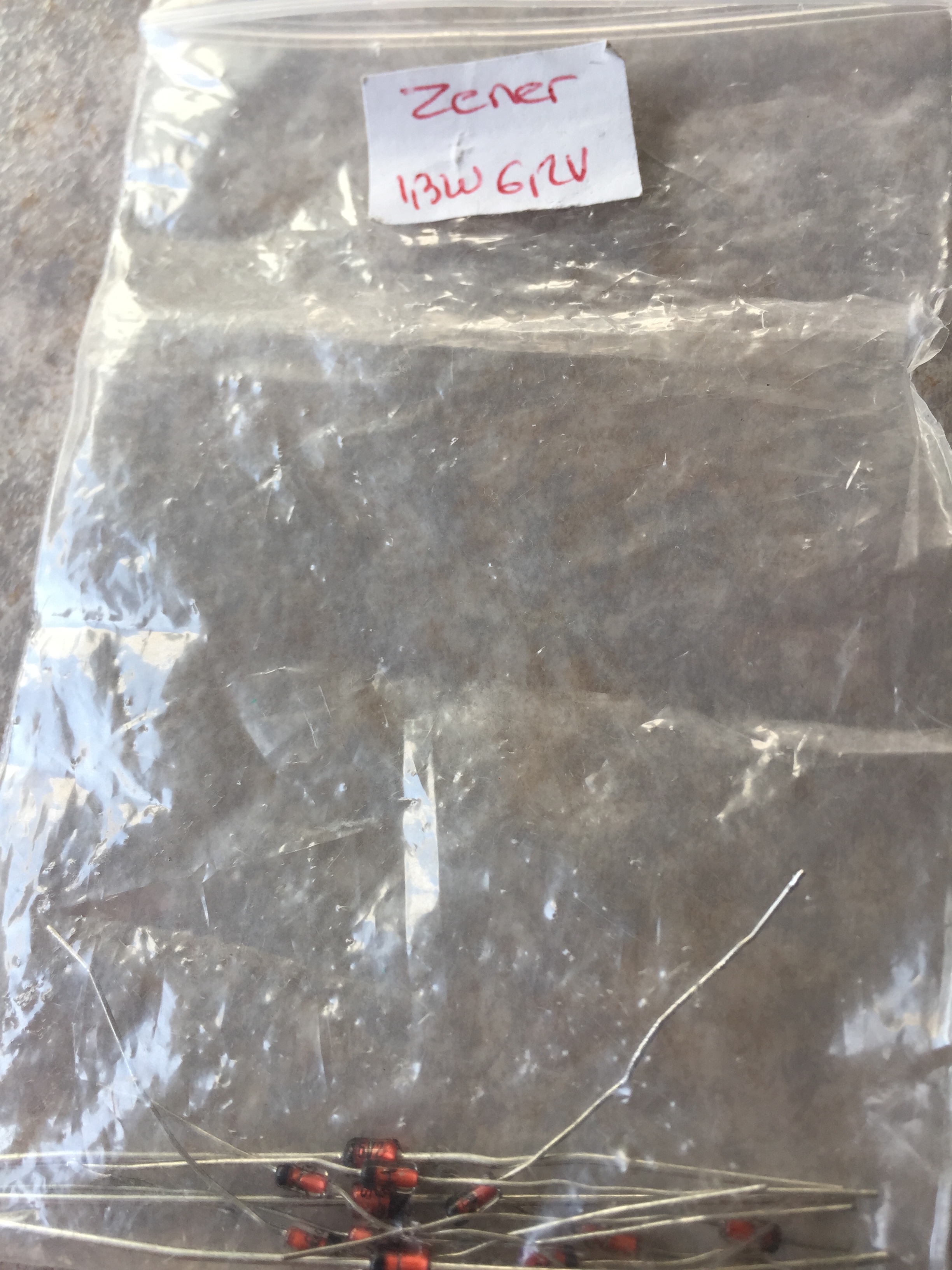

i used this one DIODE ZENER 1,3W 6,2V VISHAY tolérance 5%
the cathode soldered to t110 base, anode to the ground.
i have another brand new, i will solder it and take measurements. if it is the right diode.

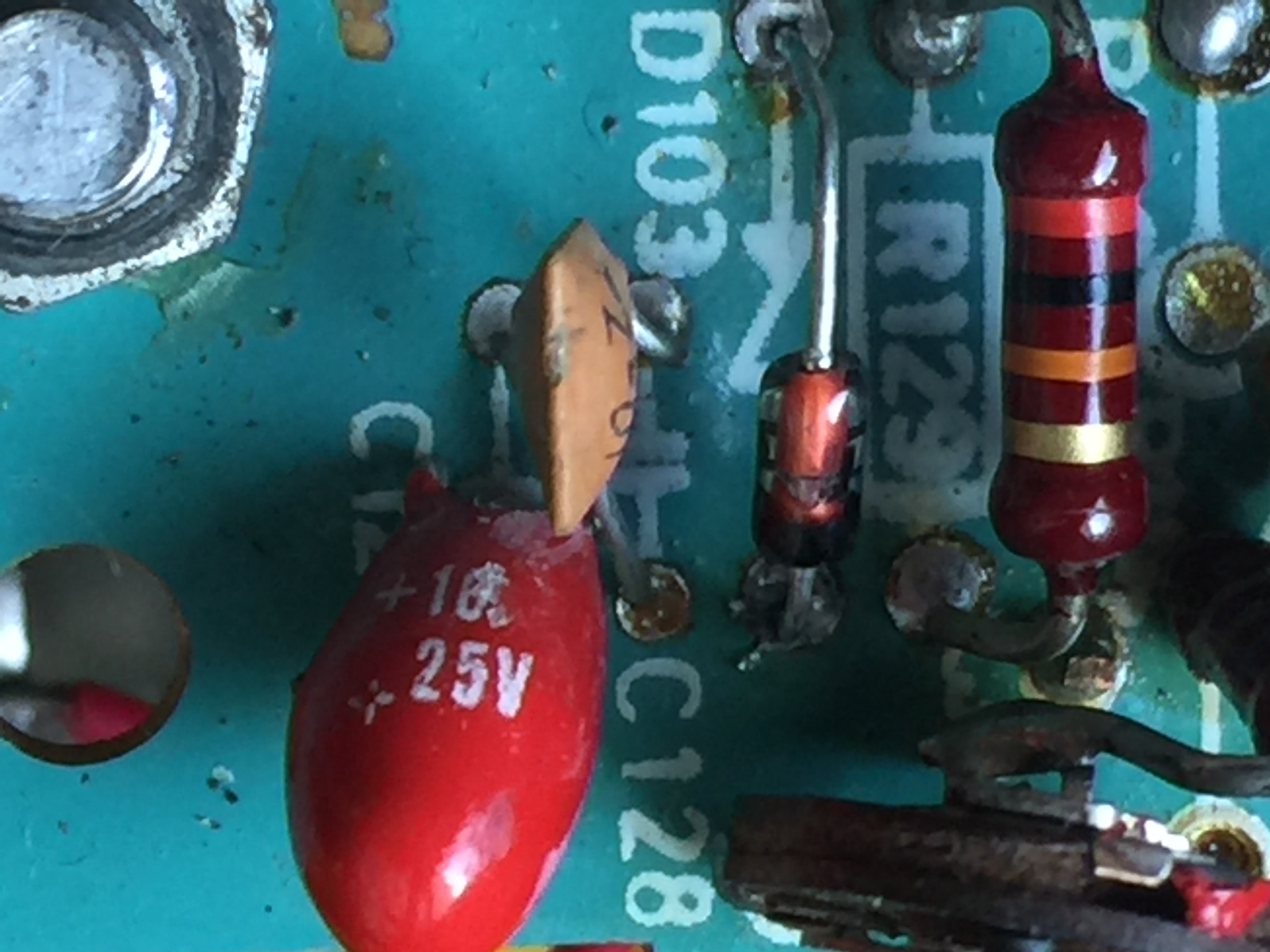

As the current through the zener diode is only about 1.5 mA a 1.3 Watt zener diode may not give the correct voltage. You would need to give the exact part number so we could look at the data sheet for it. As you have one try it first without t110 base connected and see if you get close to 6.2 volts.

This is the original d103 , i took the picture from my another working varioprop12s is written on it ITT 700 or something but im not sure. i dont know the part number of the new diode bought it here.

hi les jones i took off the diode which was on, and replaced it with a bran new one result is
i ve got 05.99 on the d103 cathode with respect to the ground. recconected the t110 base, test with multimeter set on DC black probe touching ground
t110 emiter 05.33
t110 collector 11.27
t110 base 05;99
