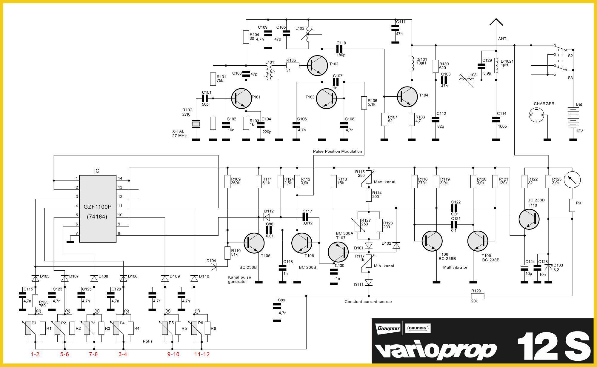

.im trying to repair an old german rc radio the grundig varioprop 12S ( yellow one) i have already opened the radio and replaced the transistor t101 the one wich is connected to the 27mhz cristal quartz because when i bought it that transistor was missing i put 2N2222 instead . when i switch on the radio it turns up and i can hear the servos jiggling but not responding to the commands. when i turn it off servos stops jiggling
i can post pictures, and the shematics of the radio if that can help.

thanks les jones for your reply here is the shematics.

The oscillator is a Colpits oscillator. The output is taken from the collector not the emitter, but that has little effect on the oscillation.
There are two issues. One is that the base-emitter capacitor is missing. Normally there is a capacitor around 50 - 300 pF between the base and emitter. For the oscillator to work, it could have been relying on stray capacitance within the transistor.
The second issue is that the 2N2222 has a transition frequency (fT) of 300 MHz. That means that it will have a signal gain of only just above 10 at 27 MHz.
The missing capacitor would be the one that provides power from the output of the oscillator back into the crystal to sustain oscillation.
I suspect that the oscillator design is heavily dependent on the secondary characteristics of the transistor.
If you can't find the exact type of transistor used, I would suggest an RF transistor, with a much higher fT, and maybe add a 50 - 100 pF capacitor between base and emitter. Of course, if you are trying to find if the circuit is oscillating, you need an oscilloscope that can measure 27 MHz. Just testing things on the basis of overall function isn't much good in cases like this.
A 2n2222 might do the job, might be better with a bf199 or maybe a plain old Bc547.
You'll need to tune L101, the capacitance will be different so the resonant freq of the tank (L101 & C103) will change reducing the o/p.
If you dont have a 'scope you could throw together a Rf meter & adjust L101 for max o/p, and L103 while your at it, not brilliant but it should get you going again.
The circuit for the Rf side looks well designed & simple, sometimes though this can mean they are picky about replacement transistors.
When I read your first post I assumed by "radio" you meant the receiver is you seemed to be talking about servos connected to it. The schematic is for a transmitter. Was my assumption wrong or have you posted the wrong schematic ? If it is the transmitter you are working on then if you do not have an oscilloscope then you could make diode probe to detect the RF. The oscillator should be running all the time but the amplifier stage is keyed on and of by the pulse train. Shorting the collector and emitter of T103 should turn on the amplifier stage to give continuous output to the antenna.

thankyou so much diver 300 for your lights .please could you tell me what type, brand or reference of the transistor with higher ft so i can buy the right one sorry im newbie.
also i need to solder a 50/300 pf capacitor between the base and the emiter of the transistor is that correct?or please could post a drawing on how to do that.

Dr. Pepper's suggestion of a BF199 seems a good one. I couldn't find where to get one when I looked.
You can solder a capacitor between the legs of the transistor. Going on the back of the board is usually easiest.
Beware of fakes on eBay. The transition frequency is difficult to measure and needs expensive equipment so transistors could be mislabelled. If you can, check the gain of the transistor. Transistors with a high transition frequency often have low gain at DC. Check the data sheet for the transistor that you are buying to see what the gain should be, and if it is too high, that could be a fake.
I tried most of my suppliers and it seems like the Bf199 is out of favour, however cricklewood electronics have some for a quid each, handy if your in th UK.
It's only 27MHz, so no big deal - I used to use BC107's (audio transistor) for making VHF 'bug' type transmitters, always worked fine, their fT is 300MHz as I recall, and worked perfectly as 100MHz oscillators.

T101's CEB marking is most likely to be the pinout, Collector Emitter Base.

ok dr depper , the bc547 has 300mhz is available i will add a 50/300 pf cap between his emiter and base as he said diver300. do you think it will work.
If there wasn't a capacitor in the circuit, it most probably doesn't need one - stray capacitance is probably all it needs. It's also likely to be a third overtone crystal, hence the tuned circuit in the collector.
