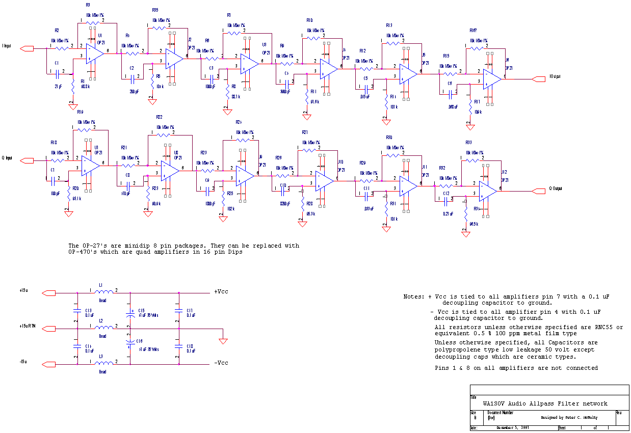

You asked for it. In Google's link about allpass filters, there is a complicated cascaded bunch of allpass filters: "This circuit will produce two outputs, which will remain 90 degrees out of phase with each other from 20 Hz to 20,000 Hz with a phase error of less than +/- 1 degree."
I'll never build that circuit.
Audioguru, is that the way they gave the schematic to you, because I can't read 1/2 the writing.
It's a schematic that is too small and is drawn with a lousy schematic-drawing program. I can see most of it on my big high-res LCD monitor.
They have another one using fewer allpass filters, but it works only between 100Hz and 10kHz.

I think that phase shift circuit is actually meant to be part of an SSB modulator...
One method that I don't think anybody mentioned yet is to use an op-amp to "amplify" the capacitance of a varactor using the Miller effect. The only limitation is the total amount of charge this "capacitor" can hold--the voltage across the capacitor is multiplied by the same gain that its C value is, and this voltage can't be any higher than Vdd - Vin (or less than Vss - Vin, depending on the polarity of Vin).
