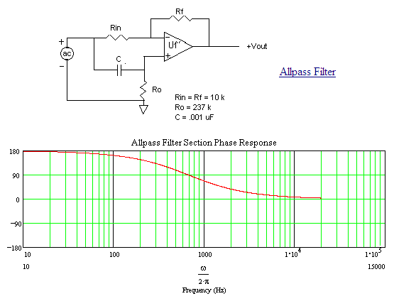

What circuits or a network act like a variable capacitor?
I know some circuits produces like if its a variable capacitor
where can i find these circuits and whats the theory behind them?

Never mind the few pF change of the capacitance of a varactor diode which is used at high RF frequencies. You need to vary the capacitance of a capacitor of about 0.22uF for an audio filter.
A 0.22uF capacitor's effective value in a filter circuit can be changed with PWM. With 100% duty-cycle it is 0.22uF. With 10% duty-cycle it is 0.022uF. With 1% duty-cycle it is ..., you figure it out. Of course, the frequency of the PWM is very high so can't be heard. :lol:

A varactor is a varicap diode and is only a few pF and changes a few pF. They are used to tune high frequency VHF and UHF radio circuits. You need to change a capacitance 1000 times more.
You also didn't hear me describe how PWM can vary the capacitance over a wide range of any capacitor. I've used switched-capacitor lowpass filter ICs for years. They switch internal capacitors similar to PWM and work perfectly.

Again you didn't hear me. PWM can vary the capacitance of any capacitor a lot.
You said correctly in another thread that changing the resistance or changing the capacitance of an RC network is the same. So why change the capacitance when changing the resistance is easier?

The PWM turns on and off a transmission gate. The gate is in series with the capacitor (or resistor) and applies it to the circuit for a selected duty-cycle.
The result is a small phase shift at lower frequencies and more phase shift at higher frequencies.
If the RC circuit is by itself then the result is a bass or treble tone contol.
If the RC circuit is in an opamp allpass filter then the result will sound like the original.
If the RC circuit is in an opamp allpass filter and is added or subtracted with the original signal then the result is a comb filter.

Walters,
A 0.01uF capacitor and a 100k resistor RC circuit produces a phase shift of 45 degrees at 160Hz.
So does a 0.1uF capacitor and a 10k resistor.
So does a 1uF capacitor and a 1k resistor.
So does a 10uF capacitor and a 100 ohm resistor.
So does ..., you figure it out.
At about 16Hz and lower and 1.6KHz and higher, their phase-shift will be 0 degrees or 90 degrees.
Change either the capacitor or the resistor to change the frequency range. Capacitors are usually switched to change the frequency range because they aren't variable like a potentiometer variable resistor that is used for the fine tuning.

Its value is fixed so it sets the allpass filter's frequency range.
what does the variable resistor values do?
The one that contols all FETs controls the amount of phase-shift at the filter's tuned frequency, and changes the frequency range of the tuned frequency.
[qiote]the variable resistor is the FET[/quote]
Correct.
Go to Google and search for Allpass Filter. Links explain what they are and how they produce phase-shift over a fairly narrow range of frequencies. One link has a circuit with 8 allpass filters in series, each tuned to a different frequency, to produce a 90 degree phase-shift from 20Hz to 20kHz without a change in amplitude. It would be a nightmare to tune its phase variably, so they recommend using DSP to do it.
Here is a single allpass filter from the link:
