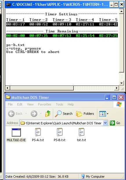

CC many thanks, please see txt attached.
  • changes4dostimer.txt

Xiptron, attached is the update addressing everything I could address. One has 5 timers. The other has 8 timers. I gave up on starting an external executable. I can do it, but the external executable has to finish and exit before returning control back to the timer program. The path in titlebar is operating system dependent. The background is gray, not white. I have to go to another screen mode to get a white background and I don't want to go there.

Hi CC. Great job and thanks. The 5 and 8 option is good. The file entry method is better now as once loaded the program is ready to be started. All the other bits and pieces are fine and I'm very happy ... except for one thing (don't kill me!!!!) - it turns out that the green font is very hard to see compared to the white settings above. I h-a-t-e to ask .. but can you make the timer text the same as timer settings? i.e white on black. DOS properties doesn't change the timing color. I also think Lucida Consol 12 pt font looks cleaner - can you make that the default? Those are my last requests, I promise lol!!!!
