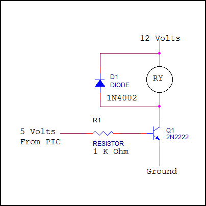

I would do as Roff suggest using the ULN2803A to drive the relays. It is designed to do exactly what you want to do from a single chip. However, if you want to go the discreet component route and use transistors the circuit would look like below attached image.
Your relays will draw about 73 mA so any number of NPN transistors will work well. I used a 1 K Ohm resistor on the base. I also used a 2N2222 and placed a 1N4002 diode across the relay coil. It gives you a picture if that helps. :)

My original suggestion recommended 2N2222 or 2N3904, but I recommended 560 ohm base resistors to satisfy the forced beta spec Ic/Ib=10. This puts the maximum total Arduino sourcing current above 50 ma, which I believe (correct me if I'm wrong) is the max allowable for Arduino. That's why I switched to 2N7000. There are alternatives -2N7002, BSS145.

Well I haven't figured out another way, just the way I will be sending 5v. Instead of connecting each control to an arduino pin I will be using the MCP23008 port expander with 8 5v lines off that.
12v Directly to the relay 12v rail. Then 5v control from the port expander pins.
So by using the transistor schematic posted it will work like this? :
Port expander line goes high with 5v, then 5v goes directly to the ground input on the relay. (Relay Off/Open)
Port expander line goes low with 0v, then ground goes to the ground input on the relay. (Relay On/Closed)
