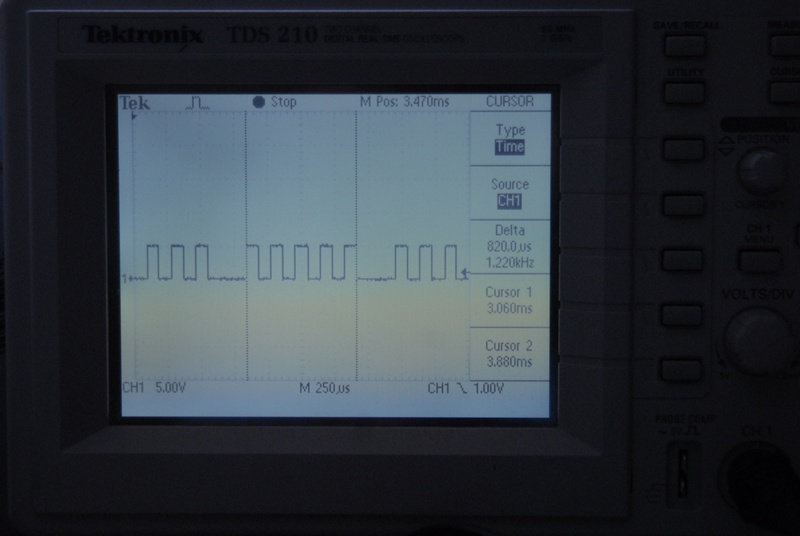

OK...
Not sure if the 16F684 is working any longer...
So I have replaced it with the 16F636 as I know that this is a BRAND NEW CHIP... arrived by mistake from microchip as I had accidently ordered the wrong device...
But thankfully both are pin for pin compatible except for the fact the the 16F636 does not have an A/D...
I have got the 16F636 now transmitting data but not at the same baud rate as before as the characters are a a tad strange... I have attached what I am seeing on the scope but I just cannot translate it... I know BAUD = bits/time
But I'm not sure how many bits are being transmitted...
It should be the letter A followed by a carriage return, new line and > indicating ready... but I beleive the carriage return, new line and > are then also re-sent out again...
The total time for 1 message is - 6.4mS in duration with the smallest bit being 80uS in duration...
  • Source Code.zip
I forgot the mention...
I have ripped out all the code... i've gone back to the working Serial Comms Code just to get something talking...
Just to make things easier...
I'm only transmitting the letter 'U' (0x55) continuously as I beleive it should give me 1/2 the baud rate if I am actually transmitting at 4800,8,N,1
The total time for a single letter 'U' is 820uS with the smallest bit being 90uS
Therefore the binary equivalent of 0x55 is 01010101
So what I am seeing on screen needs to be inverted...
So I make it 10 bits in total with 1 start bit and 1 stop bit...
10 bits / 820uS = 12195
This just don't seem right...

Warning [361] C:\Documents and Settings\Owner\Desktop\16F684 - Temperature Sensor\6th July 2010\6th July 2010 - Changed to use printf\Source Code\DS18B20.c; 119.1 function declared implicit int
Basically all three lines point to there being a problem with the way I am using the following line of code...
_delay_us(60);      // Wait 60uS for end of time slot
I've attached the code... so that perhaps you might spare some more of your valuable time assisting me...
  • 6th July 2010 - Changed to use printf.zip
Got it sorted...
I was setting
#define _XTAL_FREQ 8000000
in main.c when it should have been set in DS18B20.c (new version of TempSensor.c)
