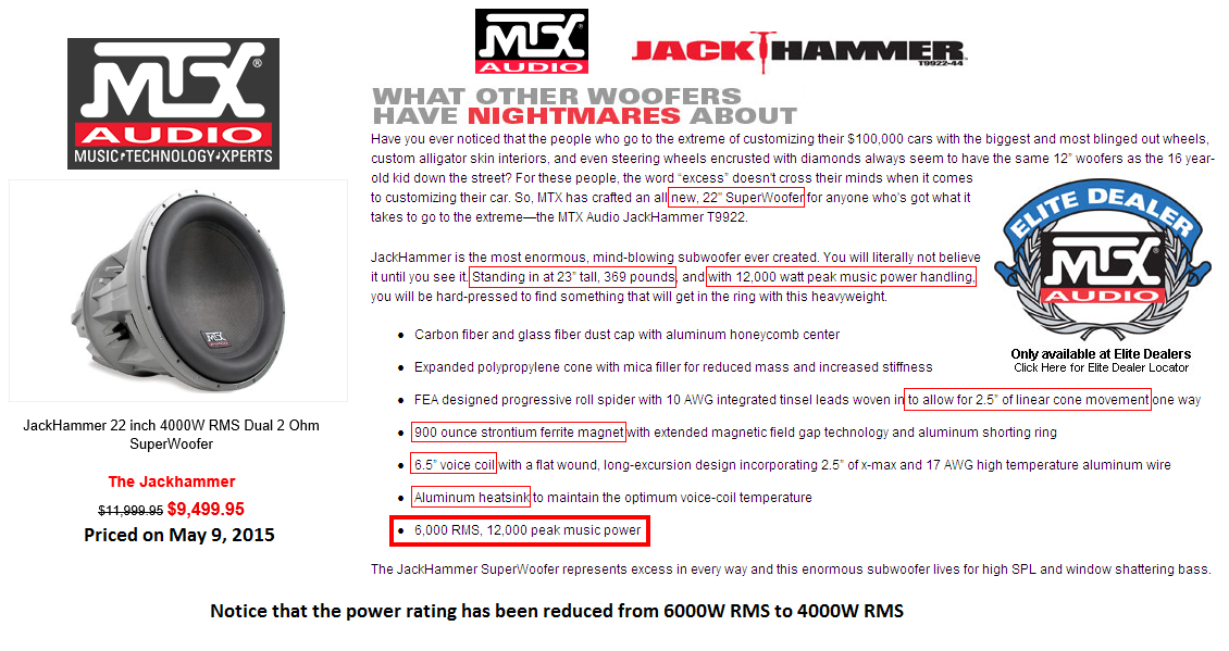

Look at the size, weight and power rating for this car speaker:
audioguru:
Wow, that's amazing.
