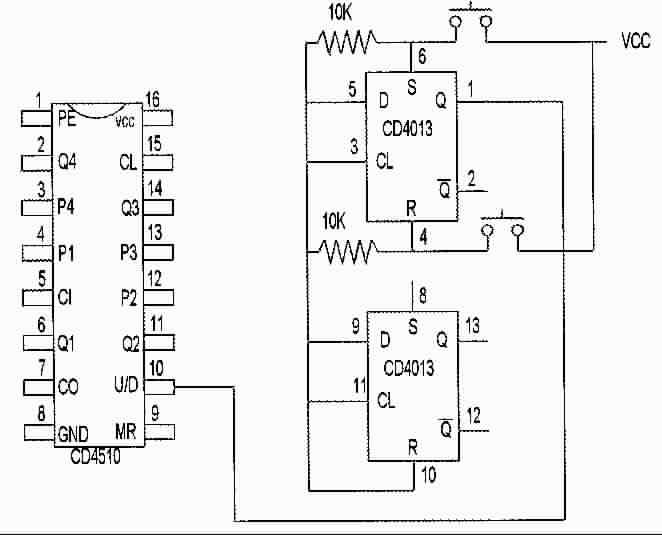

I'm looking for a good Up/Down 4-bit binary counter
I cant seem to find one that is still in production.
Any ones that are in production?
Model number?
Well I found some... but it uses one input for up/down.
High for up
Low for down
how would I hook this up as I want one button that will engage up and one that will engage down..
This is one way to do it:
You could also use a 74HC193... TI and others still make them.
