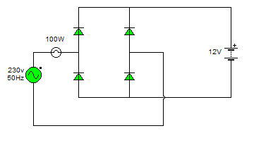

unusual way to charge a car battery

The DC value of 1.414 x RMS is only applicable when there is a filter capacitor after the rectifier. Without the the filter cap the average (?) DC voltage will still be 230volts.
sorry about that, i naturally assumed there would be a filter capacitor, otherwise there could be large voltage spikes and a lot of noise and ripple, the large spikes perhaps allowing a VERY large current to flow, possibly damaging the bulb or battery.

as stated the 330 volts is if a capaciter is used and no i was quite plain in explaining the circuit seems the simpler a thing is the more chaos is cause over it then we wounder how come it is even being patented. my current bvroken charger has not got a capcitor in it it is basically what I described with the adition of the transformer and using an amp meter as a resistance insted of the light bulb

Why would they damage the bulb when it's rated to 230V?
Why would they damage the battery since the bulb behaves like a resistor and limits the current?
because you will get voltage spikes larger than 230V that may damage the bulb, you could damage the battery by overcharging, i think it would be easy to overcharge a car battery when using little more than regulated mains, as mentioned earlier the bulbs 'cold' resistance is but 1/10 of its 'hot' resistance, this large current at 240V could probably easily damage the 12V car battery
It's a bulb designed for use at 230V AC, (peek voltage of about 330V), now why would these spikes damage the bulb when it's suitably rated?
Quite possibly but the bulb will limit the current to <400mA which is a safe trickle charging current.

Look at the scematic, are there any capacitors to store the charge?
No, the battery is connected though it doesn't act as a capacitor, it doesn't charge in the same manner, it gets to 14V or so then stops.
Is the battery connected to the output of the rectifier?
No, it's connected in series, in fact the bulb will last longer since the battery and rectifier drop the voltage so it's being powered off 216V instead of 230V so it'll actually last longer.

schematic?, did i miss something here(evidentaly) where is the schematic??
i didn't realise there was a schematic, probably where my misconception was derived from, didn't notice a schematic.:confused:

but as far as I can tell, we're talking about using a light globe, as a current limiting resistor, to charge a battery...
and I have no idea why you'd want to anyway!!! it would be EXTREMELY inefficient, using like 40watts for example, to charge a battery at 14volts/ 500mA... 7 watts?!?!?!

Can't you picture it?
There isn't a schematic but it's so simple it doesn't need one, the description shloud be good enough. Alright for nubesake I'll draw one so everyone's clear on what he means.
Look, notice how the bulb is in series with the bridge so it limits the current and the voltage across it is lower than 230V.
However, I do agree this isn't a good way of doing this, it dangerious and wasteful, you're better of using a transformer, rectifier and LM317 constant current source.

i didn't need a schematic, but someone did mention of one, i could quite easily picture that, but as has been mentioned several times before, including a transformer would be much safer and easier.
