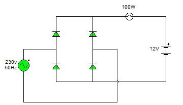

There isn't a schematic but it's so simple it doesn't need one, the description shloud be good enough. Alright for nubesake I'll draw one so everyone's clear on what he means.
Look, notice how the bulb is in series with the bridge so it limits the current and the voltage across it is lower than 230V.
However, I do agree this isn't a good way of doing this, it dangerious and wasteful, you're better of using a transformer, rectifier and LM317 constant current source.
Might be better picturing it!
This schematic has bulb in different place- (after all the discussion on the d.c voltage that would appear across the bulb).
Makes no difference, essentially all three parts are in series with each other, it doesn't matter which goes where - and a bulb will work exactly the same on fullwave rectified DC as it would on AC.

I'm just illustrating Nigel Goodwin's point; it doesn't matter, this circuit will have DC on the bulb and it won't damage it.

It would work of course for a while and then when the battery is ruined through over voltage at the plates causing holes which causes debris in the bottom which causes shorts. Put a crowbar in circuit and it will improve it but don't put it near my batteries.
No, it won't overvoltage since it won't charge to more than 14V providing the current is limited to a safe value, in theory you could connect it to a 1MV source via a super high-power, high-voltage 2Mohm resistor and it'll never over voltage since the current is limited to the safe value of 500mA.

Why wouldn't the battery see more than 14v? The battery will zener at 11-13V (depending on depth of discharge) when charging but what happens when it's charged? The terminals slowly start to rise towards the rectified voltage, outgasing will occur, and you'll damage the battery if not explode it.
Actually when the battery is accepting a change (full charge, or partial) you don't even need a current limiting device- using the batteries internal resistance is perfectly fine to limit current, but when the battery is at near full change the voltage must be reduced to the approriate float voltage level.
That may be the case in a car when the alternator voltage is never any higher than 14V but this isn't the case here. The battery won't be damaged since the current is limited to <400mA by the bulb, which is a safe for a trickle charge.
