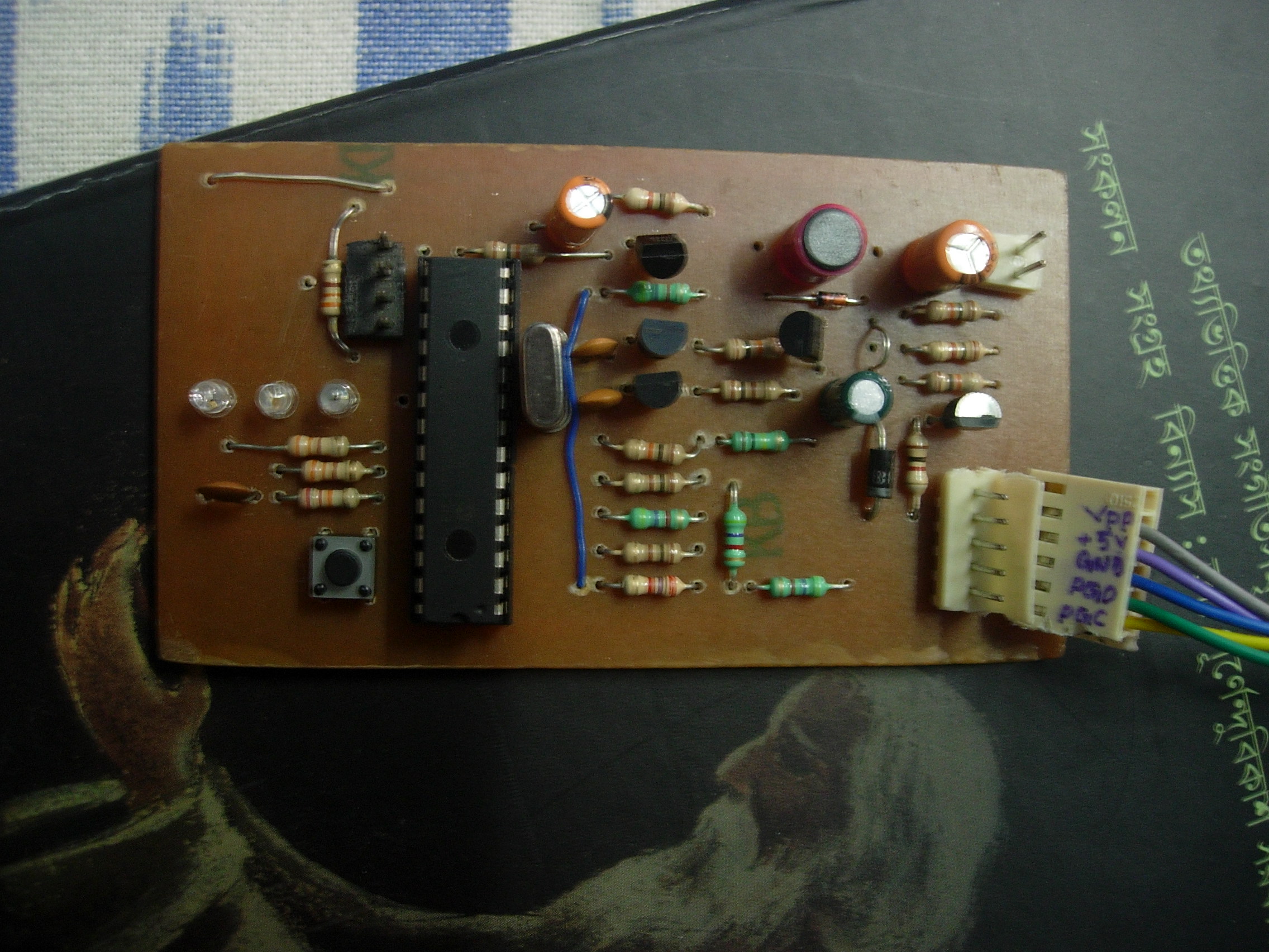

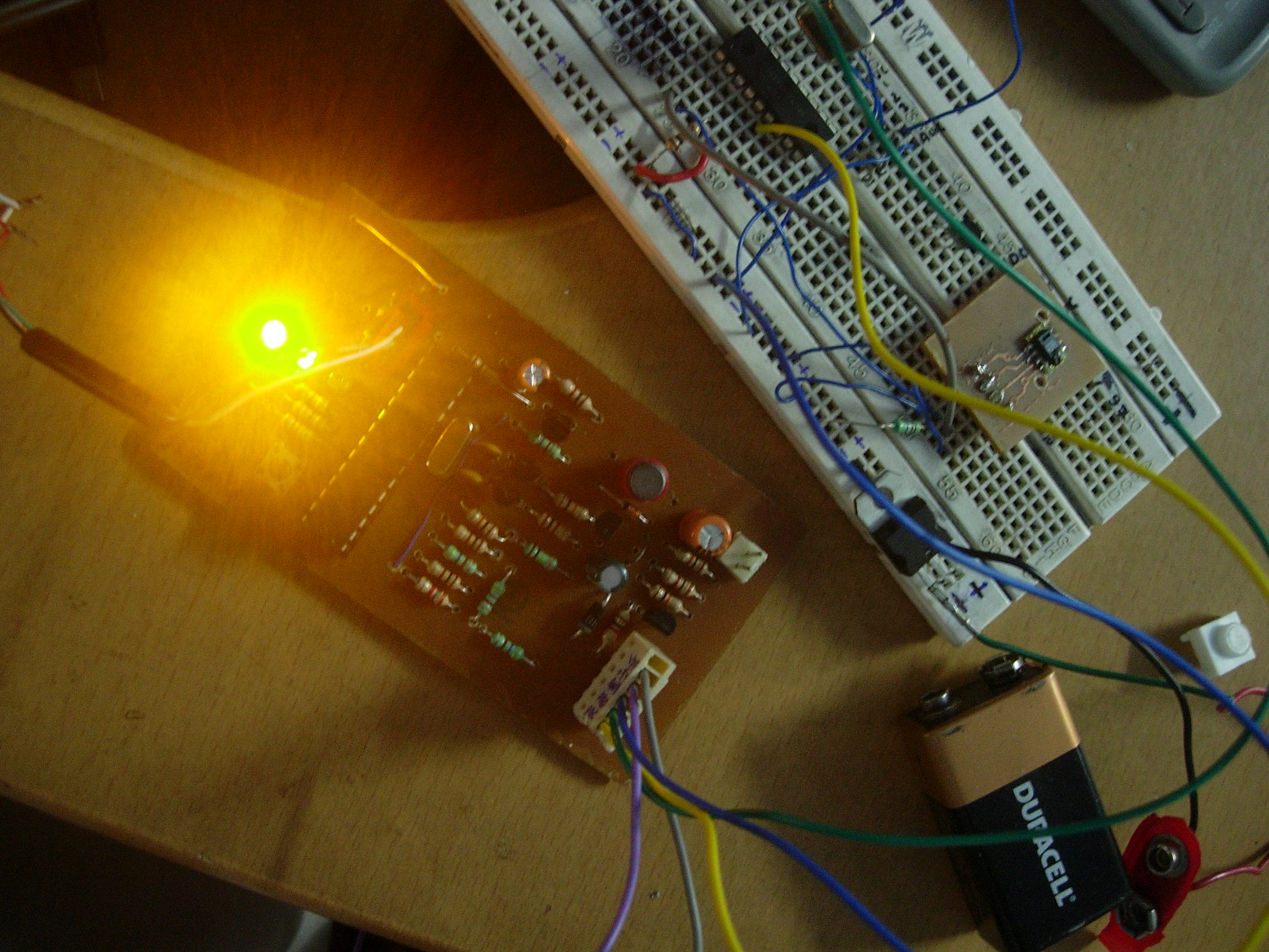

But I've made another nice PICKit2 of Gayan Soyza and mine PCB layout....really good...it works 100% perfectly without any trouble......here it's...

huhhhh!!!!do you like my selfmade pickit 2 aka junebug??
